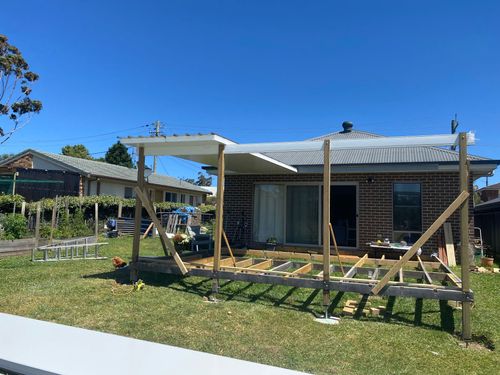

Needed an outdoor space ,protected from the elements.Bit of a handyman so set out footings and knocked up the framework.Had an engineer to pass off my footings and spacing. Bought 100 mm,6 mtr x 1 mtr insulated roofing panels.
Bags of cement and aggregate and sand
Stirrups
Galvanised coach bolts and nuts
Joist hangers
Heavy duty galvanised clout nails for joist hangers
140 x 45 mm h3 treated pine timbers

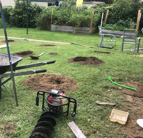

Petrol post-hole digger
shovels
large pinch bar
wheelbarrow
wTer level
circular saw
impact driver
camoflage deck kit for secret screwing
handsaw
electric planer

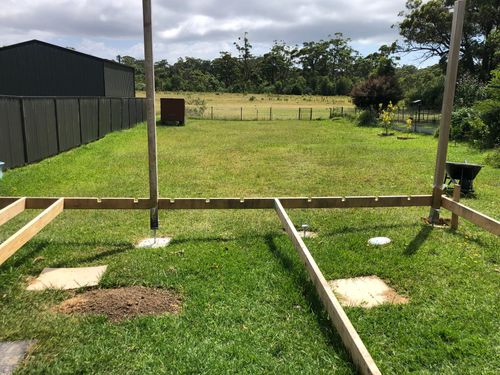

Step1-mark out string lines and pegs
step 2-dig out footings
step 3 -anka-screw ledger beam to house brickwork

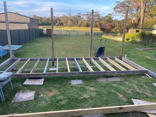

step 4-fit 6 mtr x6 mtr frame
step 5- check diagonals for alignment

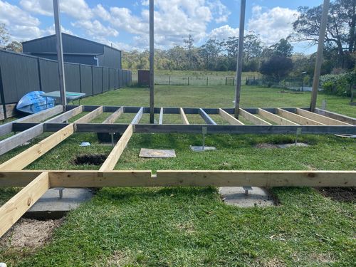

step 6- install bearers
step 7-install joists (both are at same height )

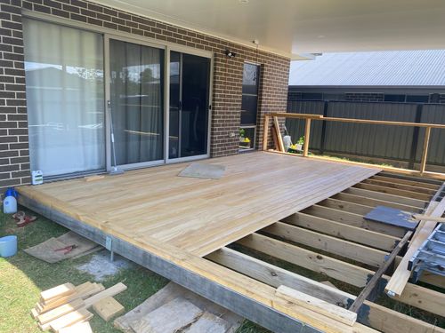

step 8- lay decking (A grade treated pine)
set out framework
Start to dig out footings
Install bearers and joists
Used joist hangers and a half checked housing for more strenth

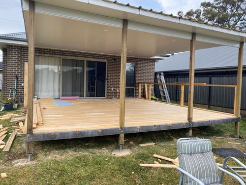

Start to install the 6 roofing panels

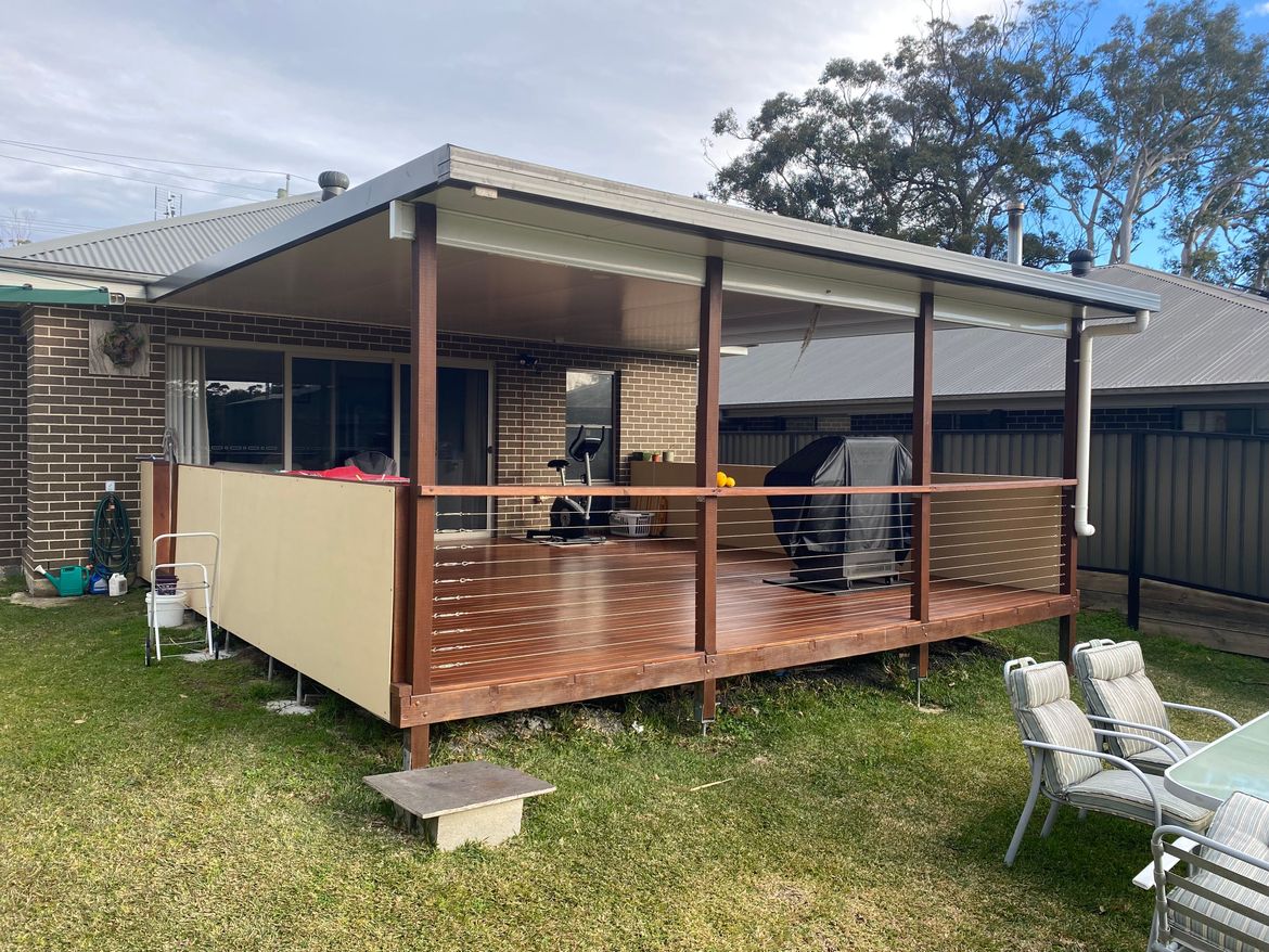

Now I had protection to start laying the deck
Deck is finished
Last jobs were staining the deck,handrails installed ,ballastrad installed and painted fibro sheets lining the side rails
Finish

Thanks EricL,
Installed a DIY downlighting kit,so no need for a sparky.Have 2 more projects to upload
