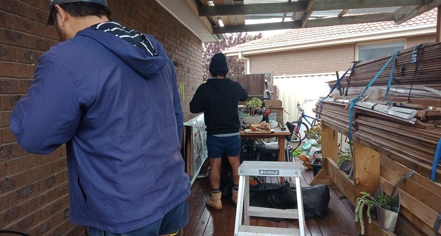

This is the deck area, as you can see this is a before photo, before the framing and cladding was done. Water was roughed with the waste inside the frame and the cladding will hide our waste and water lines to our sink to make it more appealing than being exposed.

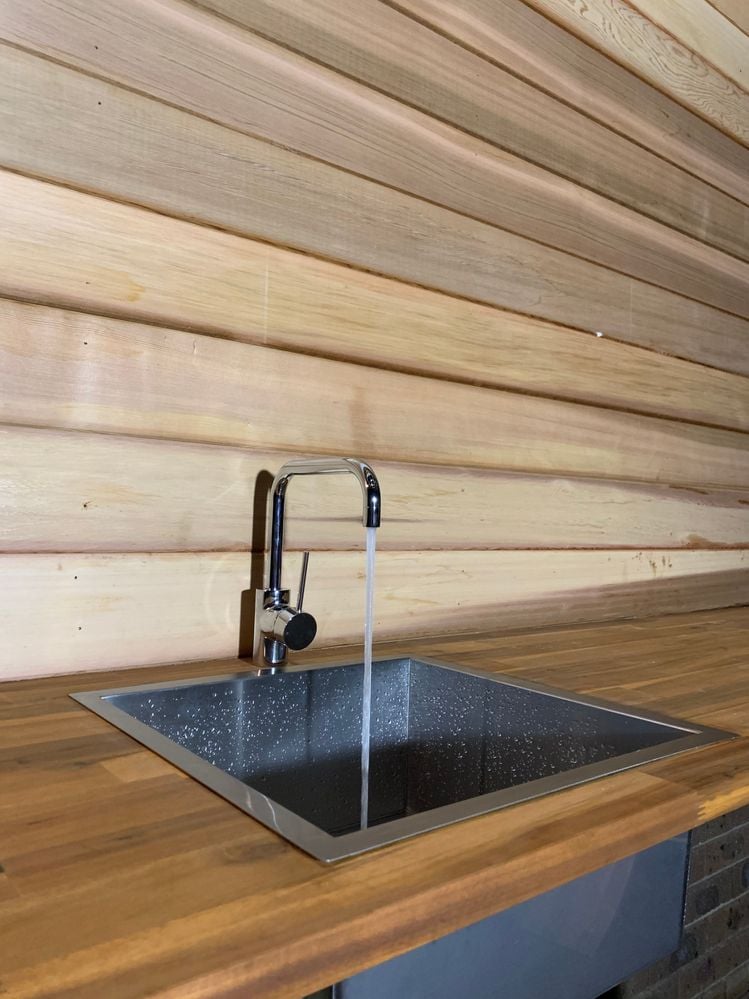

Cladding has been installed and not stained. Acacia laminated panel was used as our benchtop and a 100x100 post was used as supports for the legs. Caroma flick mixer was installed along with the Mondella Rococo Sink purchased from bunnings.

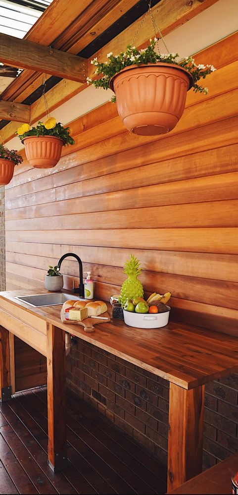

Our "sort of" final product as of Monday (14/09/2020), stained the cladding using Feast and Watson screening oil and kitchen timber oil for the laminated panel. As you have noticed I changed the flick mixer to a black one. (Dorf flick mixer) a spare which we purchased at Bunnings a few years ago. I think it personally looks better with the black 😉
