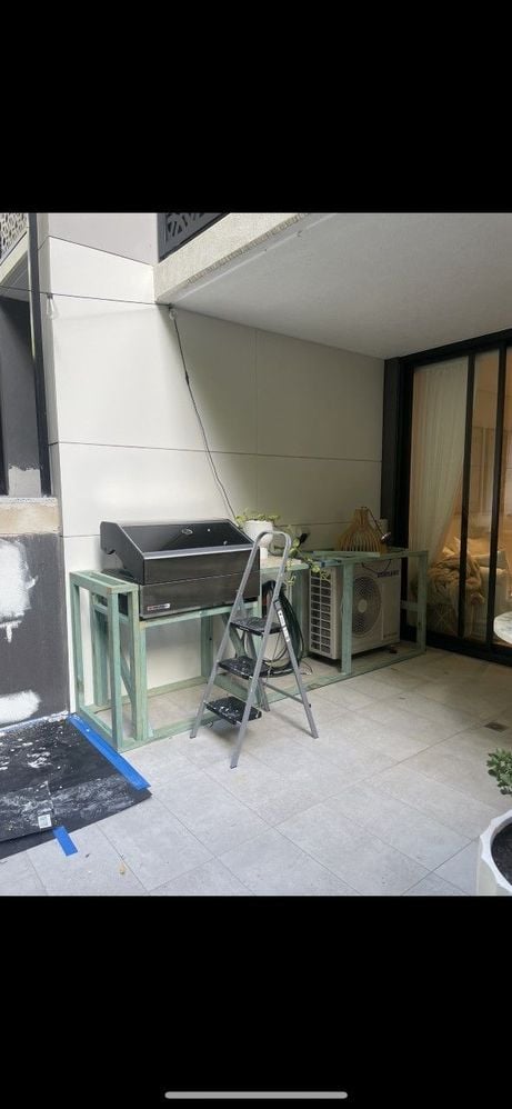

We are building a built in outdoor kitchen in our courtyard. We have the frame completed and a photo of the inspiration for our doors. We will have bigger spacing between each wooden piece on the doors. As we are making it seamless with the aircon, we will have the same wood pieces but no backing where the aircon is for airflow. We are thinking of using Primed Pine 42 x 11 H3 Design Pine F/J Primed DAR Dressed All for the wooden pieces but not sure what to use for the backing to shape the door for them to stick onto?
We are going to (attempt!) to do a white concrete top for the outdoor kitchen and put strip lighting underneath.
Open to any suggestions!

@emmamay Looks like it will be a great bbq area, just a suggestion for the aircond cover/door, please make sure you allow enough gap for air circulation, when installing the panel for the Aircond you could hinge it from the bottom attached to a gas strut or chain and latch to allow more air circulation during use.
