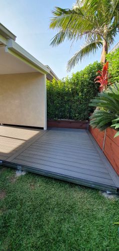

20210507_142744.jpegG'day DIYers. Thought I'd share with you the biggest DIY project I've ever attempted. We're basically extending our alfresco area to include an awning, deck and outdoor kitchen.

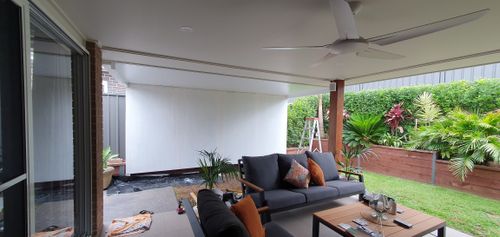

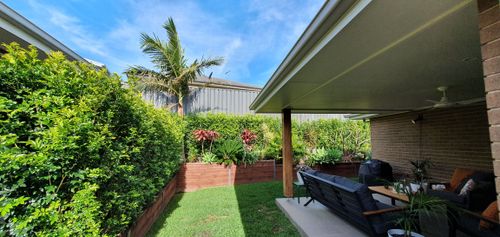

Here is the space, I hope you enjoy the journey as I embark upon new DIY methods never done before. I consider myself quite handy, happy to give anything a crack once.

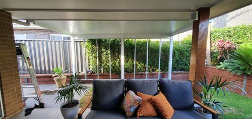

We started with the awning. I was going to purchase a kit and install it myself. Stratco kits were so expensive so I employed a local builder to supply and install for pretty much the same cost.
The goal for the whole project was to produce a maintenance free area. So we chose the use of steel and composite materials throughout.
The awning consists of aluminium posts, beams and gutters. The ceiling is insulated and we incorporated 2 led lights to match the LEDs in situ under the alfresco.

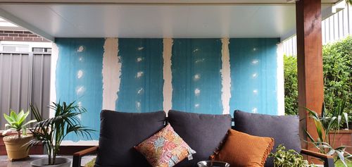

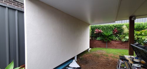

To ensure the space is weatherproof, I constructed a steel frame using Krauff tracks and wall studs from Bunnings. This is to support the blueboard sheets.
Mounting the sheets was difficult, just because of the weight of the material. Thank goodness for quick grips.
Then I applied the cement joint compound to cover the joints and screw heads.
We chose the finish the kitchen splashback with Dulux Texturecoat. First we primed the wall.
Nearly stopped the project there and converted the area to a home cinema,  but we pressed on and applied the texturecoat.

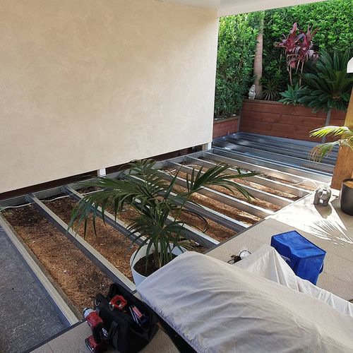

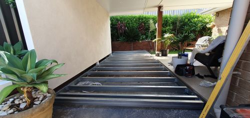

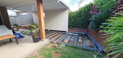

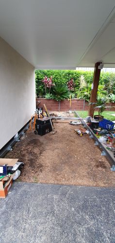

Then it was time to construct the deck. The sub-floor would be built using 100x500x2.0 galvanised steel bearers and joists on a single plane. The 2 main bearers would be attached to the side of the alfresco slab and attached to the awning posts. The bearer on the house side is 7m in length and extends beyond the alfresco to the retaining wall. Getting those 2 bearers installed was challenging due the weight and lengths.
After that I set the posts and attached the remaining bearers and joists.
Prior to this I ran power and water from nearby sources. I also have a stormwater drain at the rear corner where the awning gutters feed into.
The sub-floor follows the level of the alfresco which falls away to the rear of the yard. This is evident when you see the bottom of the splashback and the level of the bearer.

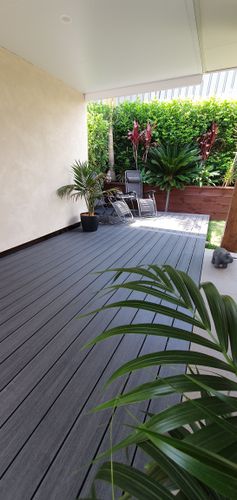

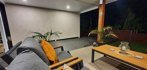

After completing the sub-floor, we ordered the composite decking from Bunnings (ekodeck) and installed the boards. I chose to install breaker boards to avoid any butt joints in the decking boards.
And added some chairs for looks.
Kitchen construction time. Another trip to Bunnings to purchase appliances and the material for the kitchen cabinets. In keeping with the maintenance free theme I choose 65mm Klauff steel tracks and wall studs. They were built around the 2 door Matadoor fridge also purchased from Bunnings.
So that's where I'm up to as at 12 March 2021. Will keep you posted as I continue. Next step, connect power for the fridge, purchase cabinet cladding, bench tops and install sink and bbq rangehood.
