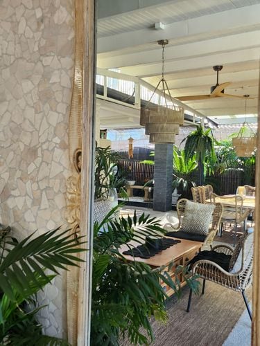

Next project was covering up the existing painted brick wall. This was a sand based paint that was used to cover burnt brick from a fire to the back part of the house many years previously.
Seeing the Mosaic tiles at Bunnings and previous travel to Indonesia gave me the idea to do the wall in the tile.
Special order desk was a blessing for me and got to know the staff well with all my ordering.

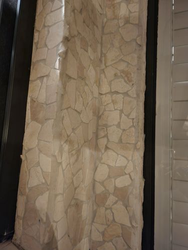

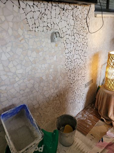

The tiles went up and then I Mosaic spare pieces around the corners of the windows and the rear door.
Then teaching myself to grout with Bunnings online videos.

The smaller wall first as easier to put up with no fitting around windows. Also a bit of a learning exercise before taking on the larger wall with windows involved.

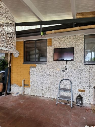

The second wall covering the yellow paint by layering the Mosaic tiles over the top and then cutting out small Mosaic stone pieces to fit around the windows
Window and door, just like a jigsaw puzzle
Step 4

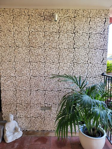

Slowly grouting the wall which I actually enjoyed. A bit rough on the hands at times but managed to get the consistency of grout worked out ....it's a bit like batter for a cake !

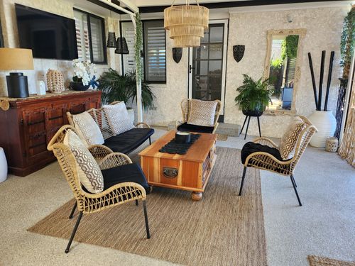

Both mosaic walls Bunnings tiles completed with plants, outdoor rugs

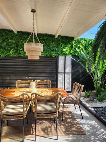

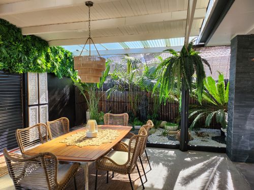

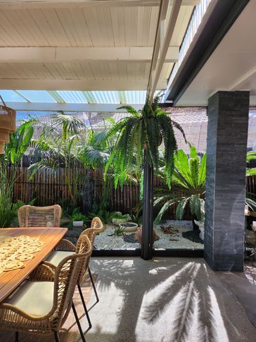

View of the other end of the entertaining area.with painted ceiling.

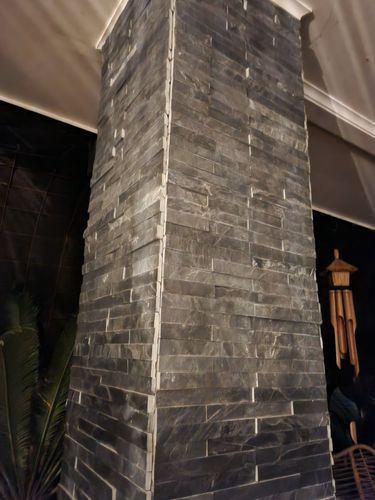

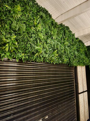

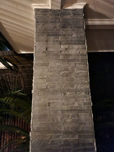

Added the Stone around the pillars by using the Decor8 400 x 100 Silver black stacked stone and placing onto brick pillar using Adhesive glue. Next came placing above the pool room was the Bunnings UN REAL 50 x 50 Artifical hedge Bosten fern. I fixed these on by using my husbands nail gun Ryobi Airwave from Bunnings

The pillar stone work
The pillar stone work up close using the Decor8 400 x 125 Charcoal grey and Adhesive glue. Slowly working from bottom up

Fixed the Bosten tiles with my Husbands nail gun Ryobi Airwave and clipping them together. A bit of trimming up the top was required to fit around the ceiling beams

Bought furniture to complete and decorate both ends of our Outdoor room

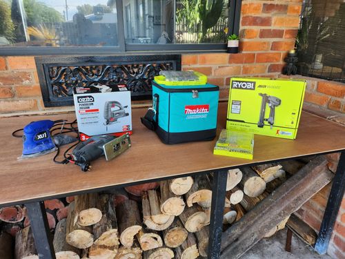

Bunnings power tools
