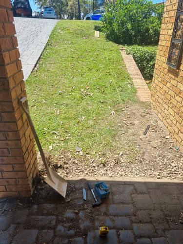

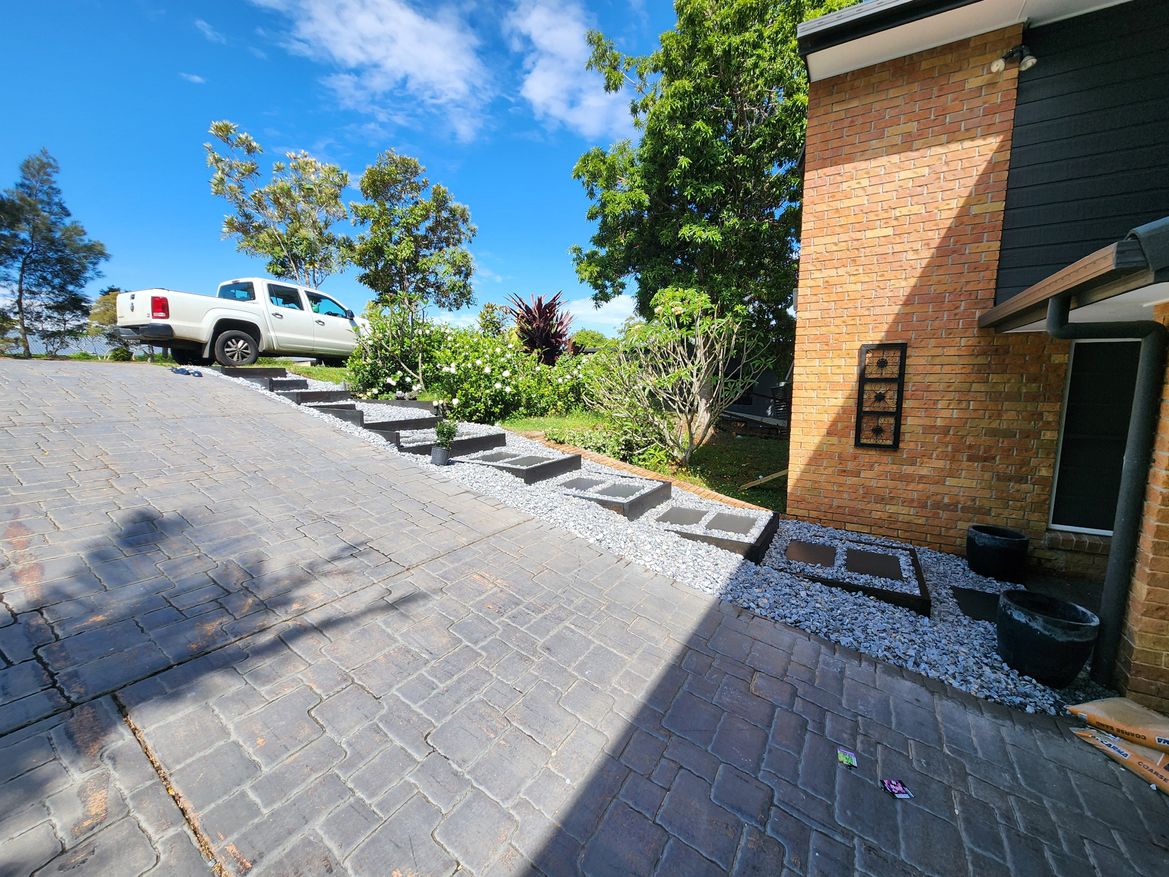

Short and steep driveway only access to house apart from grass.  Had time and an optimistic outlook.

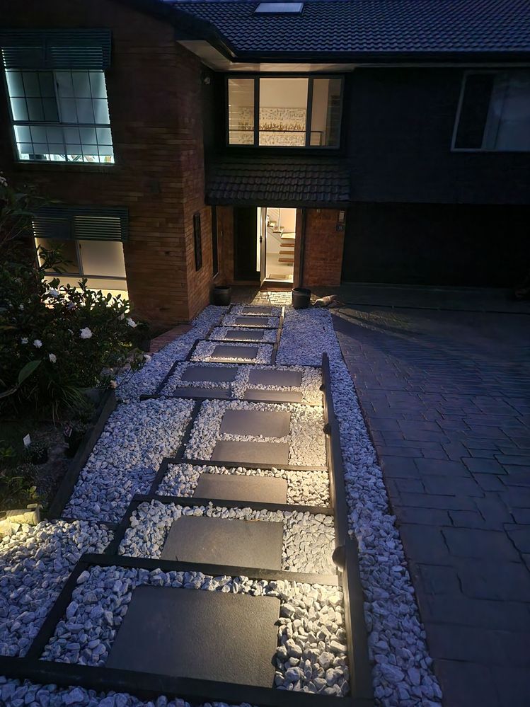

Solar step lights

PLAN - it was quite a steep slope and needed to ensure horizontal length was accurate to keep within property line whist maintaining spacing, comfort, and visuals.
Step 2
Mark out with string lines and marker paint.  Bear in mind risers sleepers are 50mm and if butting to end of side sleepers this needs to be added to measurements by number of steps.

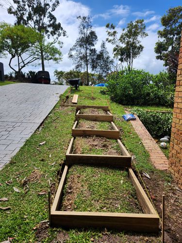

Step 3

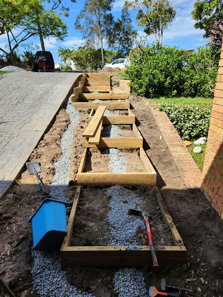

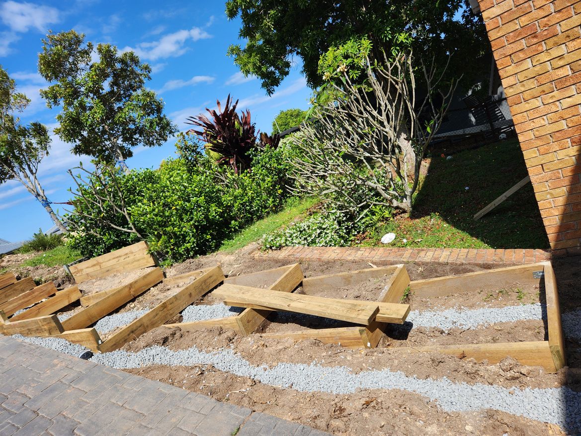

Start at the bottom as the riser sits on top of the side sleepers.  Initially I really only dug out enough to settle the sleepers on a small amount of road base.
NOTE: levelling is critical but, especially with the side sleepers, level does not necessarily mean the same height.  Over 1200 or 1800 this can lead to lots of swearing.  Levelled string lines during construction are a must.
Sleepers secured with angle brackets & 12mm rebar.  I should have driven the rebar through all risers at the front of each step as well as the rear.

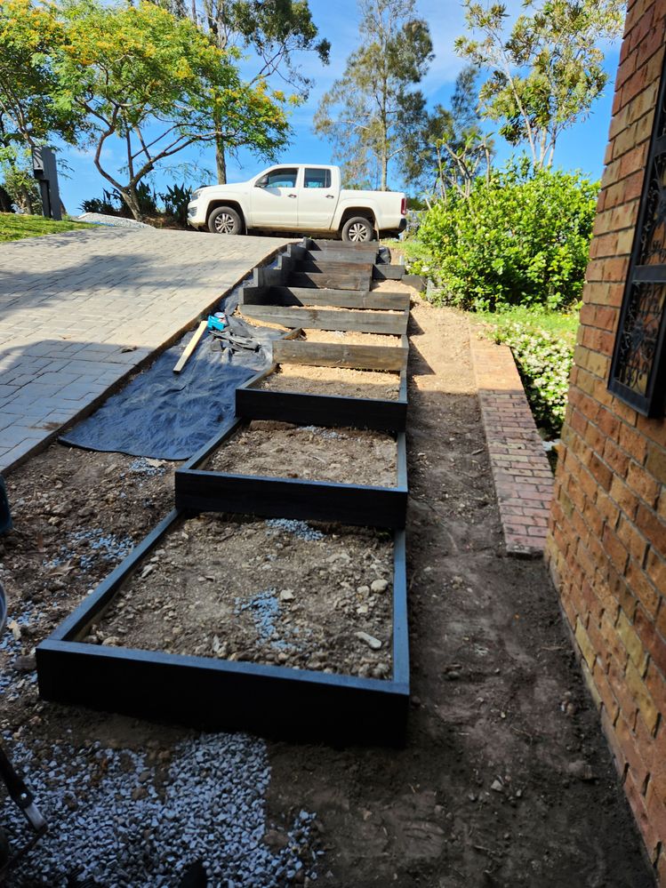

Step 4
As the slope angle increased significantly in the top half extra rebar required as well as a lot of excavation.  We dug out almost 4m3 and disposed of 3m3.  The one metre was used to back fill.

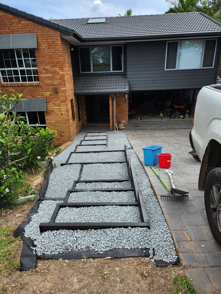

Step 5
Drainage - as the soil was quick rich in clay one 75 mm sleeved ag pipe was set down the middle of the stairs with another between the driveway and side sleepers.  These joined to drain into existing spoon drain. Drainage gravel over.  Weed mat, then covered with drainage gravel.
STAINED sleepers at this point.
Step 6

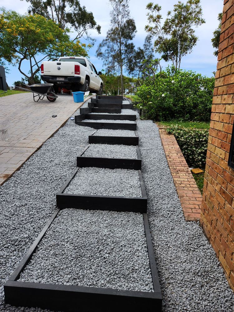

A bit too much drainage gravel for the job.  Unloaded and spread by hand so no way I was gonna not use it.

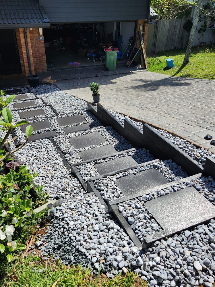

Step 7

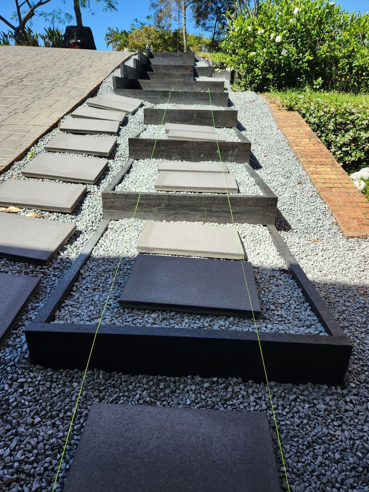

Paving : Be patient.  Ensure levels are good and pavers on each step the same height.  Use string lines.
20241025_134121.jpg20241028_140643.jpg20241028_140722.jpg20241029_183246.jpg20241012_104621.jpg

This is a fantastic project @SMJGGT!
You've managed to turn a boring, potentially dangerous grass path into a beautiful, extremely usable feature at the front of your property.
The outdoor lighting was a fantastic inclusion that really shows off your work when it gets dark.

Now thats a decent amount of hard work. It looks great and I really like the forward thinking of drainage and lighting within the build. Having built some steps and also some paved slopes I totally get the "cursing" over straight lines and falls :smile: Worth the effort for sure.

Love the low voltage lighting to enhance your work at night. Great job @SMJGGT

That’s an amazing result and it’s made a huge difference to the street appeal of the house.
