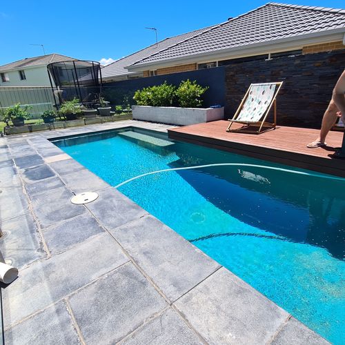

looking at resurfacing or painting outdoor tiles to freshen up area until I retile in two years time.

My advice would be to use Crommelin Natural DiamondCoat Slate And Stone Sealer to rejuvenate the area. I really like these pavers' look and would be hesitant advising to paint over them. It appears like they desperately need a sealer, which will return most of the beautiful colouring. Are these tiles slate? If so, I would imagine they'll look quite spectacular once sealed. It would be best to give them a good scrub down with a stiff bristle broom and a pressure washer. Once the cleaning is complete, try a test section of the sealer to ensure it adheres correctly.

Yes they are a stone. My husband sealed some previously but may be a poorer sealer or rain after as it wasn't too good.
I will get the pressure washer out and get working.
