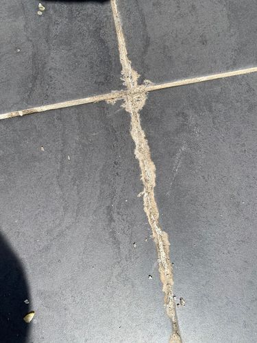

Hi, I’ve decided to regrout and reseal our outdoors balcony due to loose grout and effervescent. I would like some advise on how to get started and products to use. I wouldn’t class myself as a handyman

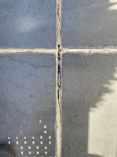

Some of the grout looks ok so I’m not sure how to determine whether to remove it all or just the “crappy” loose bits. Fair bit of effluence to clean up too I was wondering what best to use on that. Yes the tiles are glazed. Thanks for the quick reply

@Geek1967,
You can take a flathead screwdriver and chase out the damaged grout portions until you hit solid material. If the grout crumbles easily whilst digging it out, then it needs to be removed. You'll not only need to take out the loose bits but also chase the grout back until it becomes solid. If you only remove the loose bits and fill, chances are the adjacent old grout with deteriorate within the next few years. If it does look like the majority of the grout has deteriorated, then your best bet is to pick up a multitool. Combined with a diamond blade similar to this one from Powefit, that will be the quickest option. I wouldn't advise using a manual grout remover unless it is just small sections.

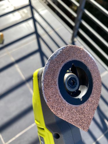

Got the multi tool and POW fit as recommended. Started grinding and the old grout is like concrete. Hardly making a dent on it

Is this the damaged portion or other more solid areas of grout that are giving you difficulty? Is there gold-coloured carbide left on the edge of the blade, or can you see the steel?

Both portions both solid and damaged are giving me difficulty. I’ve only just stated using the blade, maybe 20 minutes trying different areas but it’s all solid. Blade is still good

Can I confirm that the blade is firmly attached to your multi-tool and that you're putting at least light pressure on the tool? Is the blade thin enough to only make contact with the grout and not the tiles on either side?
By using the multi-tool and carbide blade, it should be quite a fast and effective method. For instance, it should only take around 60 secs to cut out a 30cm length of grout. I've added an instructional video below to illustrate.
