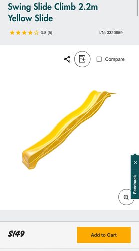

Hi Eric - I’ve uploaded a photo of the one purchased. Reason for painting is because our local stores plastic slides were very faded and also wanted it to match the cubby house as well. I was hoping someone might know if there was a good quality paint that would work or if it might require a seal if we paint.

Thank you for posting the picture of the slide you purchased. I suggest removing all the White Knight paint that you've placed on the slide with a Pro Renovator 100mm Plastic Scraper. Once the slide is clean and back to its original form, I recommend using Dulux 1L PRECISION Maximum Strength Adhesion Primer White to prime the surface of the slide. This particular primer is designed to go onto difficult-to-paint surfaces. I propose a minimum of two coats and make sure to give it enough time to cure before you paint over it.
Once the primer has cured properly, I propose using Dulux 4L Aquanamel High Gloss White Enamel Paint. This is a hard-wearing paint and is often used on doors, skirting boards and window frames. Because it will be used on the slide, it will eventually wear out and a new coat will need to be applied. Please note that the top coat must be sun-dried and solid before using the slide, if used too early the paint will chip and tear.
