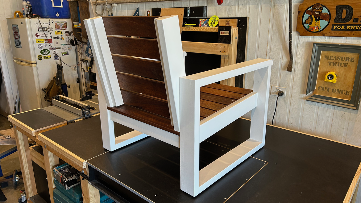

This might just be my favourite quick win project yet. A modern, designer-style Patio Chair using nothing more than 90 x 35 pine, some decking boards, a handful of screws and basic power tools.
No fancy joinery.
No expensive gear.
Just a simple, satisfying build that you can knock up in a weekend. Hope you like it 👍😁

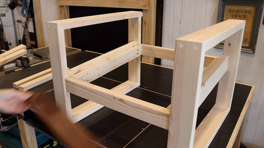

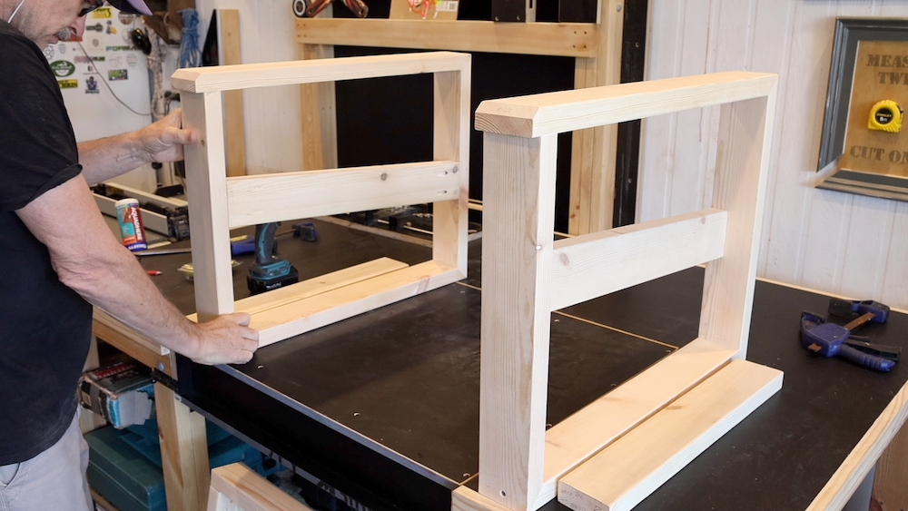

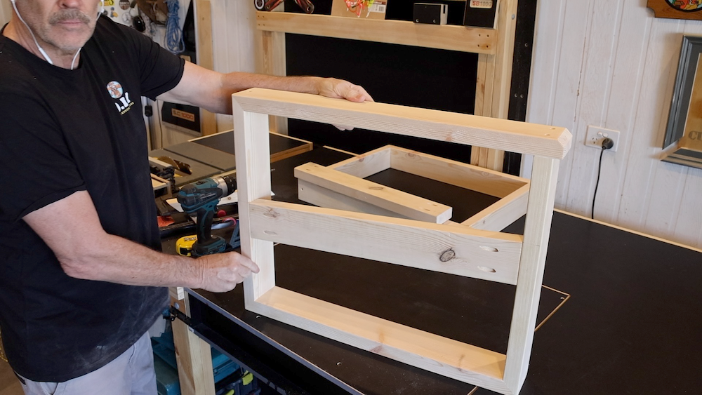

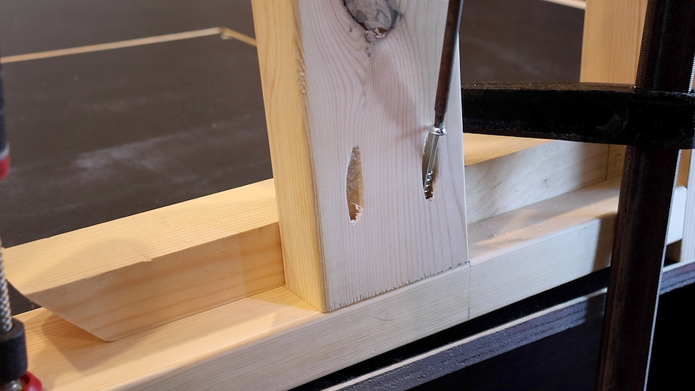

Step 1
Build the two Outside Frames including the Seat Support.

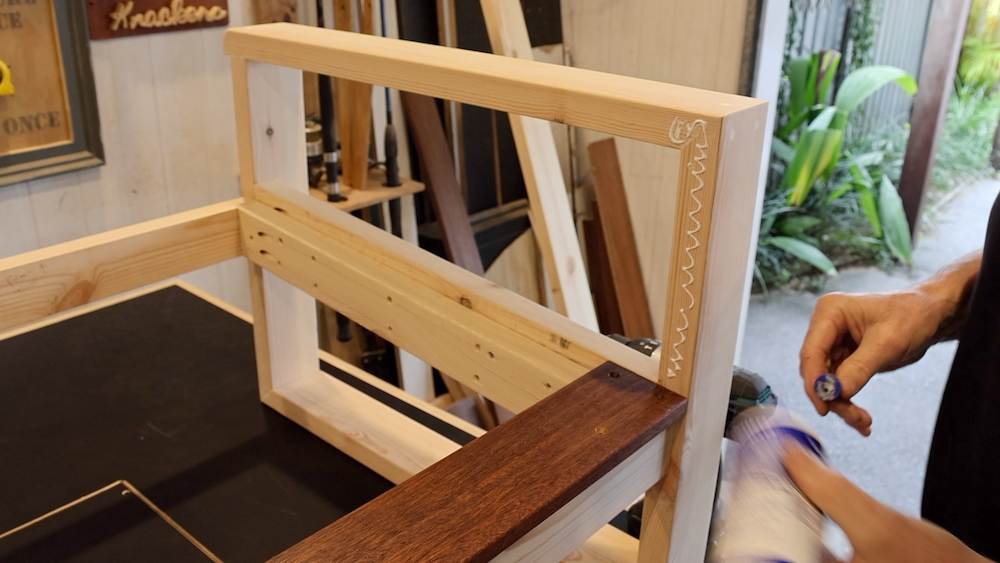

Step 2
Make the Seat Frame and attach to the two Seat Supports.

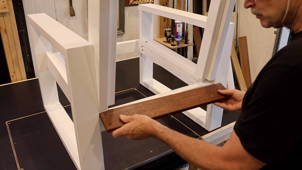

Step 3
Cut and attach the Back Support to the two Side Frames.

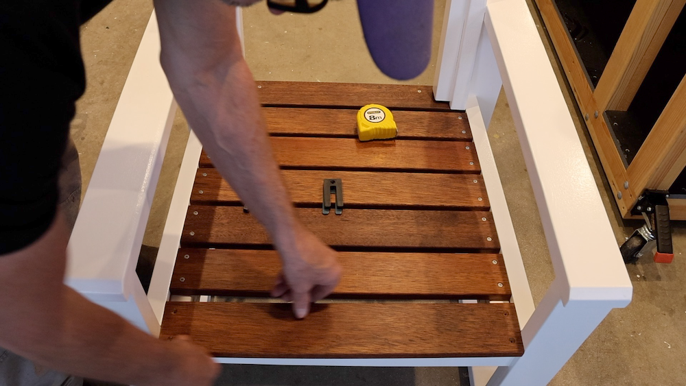

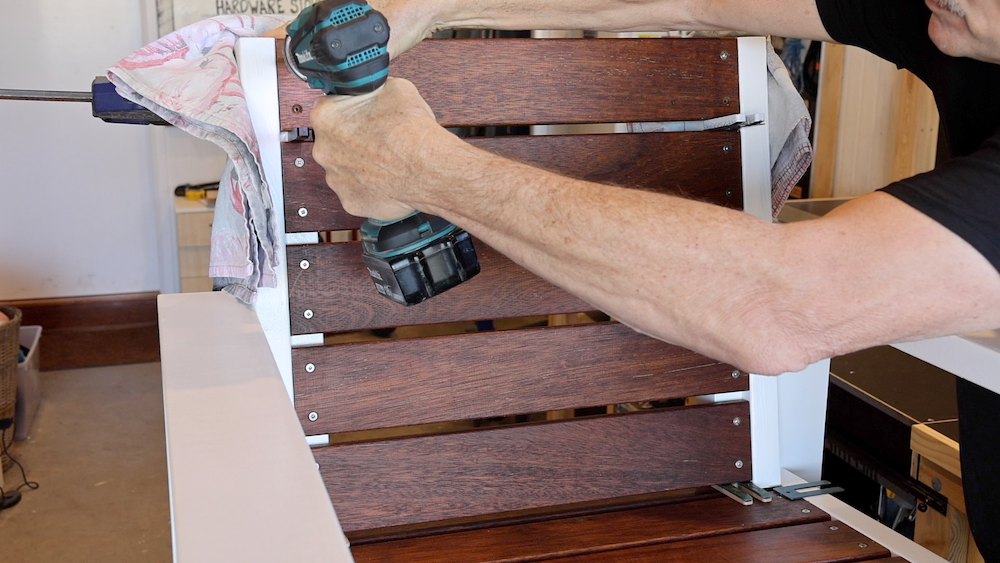

Step 4
Cut and attach the decking board slats to the seat and the backrest.

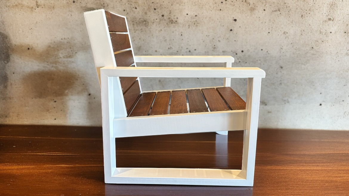

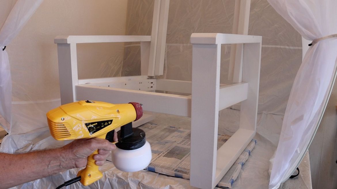

Step 5

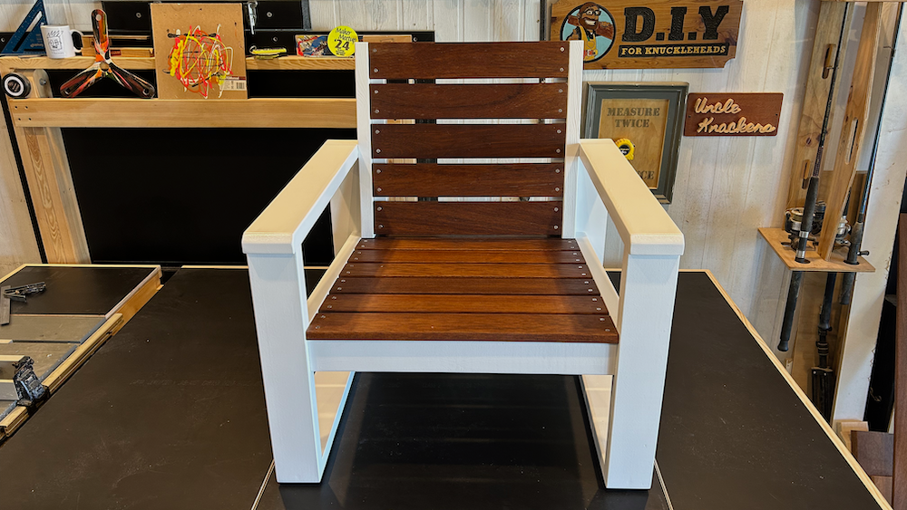

Please Note: If you decide to paint your chair, do that before you attach the slats to the seat and the backrest. If you don't paint, staining is a great option and also a lot quicker.
