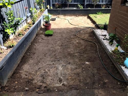

I am laying pavers in a section (about 15 sqm) of my backyard. I have excavated about 100 mm of soil from lawn to start preparing for the site. - Please see the picture.
I am thinking to add a layer of crushed rock compacted to 40mm-50mm and then another layer of paving sand (about 20mm) before I lay down pavers which are 40mm thick. Is it a good enough base or should I do more. There is no tree around and it will be mainly foot traffic.
Another concern - Though, I will ensure that have slope away from foundation of building but during a heavy rain can water seep into the pavers and may create the problem?
I have clay soil underneath. Some people lay down a geo-fabric under the crushed rock. Is it a good idea?
Please see the picture of site, if the water seeps into the paver then it will not have any drainage other than go into the ground naturally. however if water can flow through the surface of pavers then I think it is not an issue.
