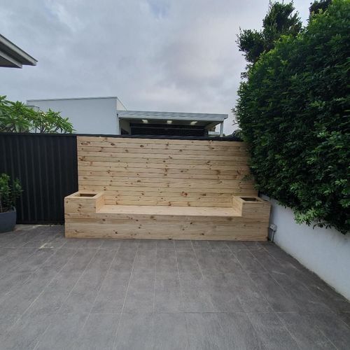

I built this planter box with an incorporated seat and privacy screen - in only 10 hours with treated pine decking, lumber and hardware from Bunnings.
The boxes are 450x450 and 700mm high, the seat is 2700 long and 450 high, and the privacy screen is 1800 high by 2600 long.
For the frame, I notched all the uprights to accommodate 2 x 3600 long frames. and cut a lot of 450mm cross embers to tie the front and back together. I completed the entire screen separately and bolted it onto the frame with 6 x M10 100mm galvanised bolts.
All up it only cost about $800 with the decking costing about $500 and the frame $250. We only required one box of 500 Stainless steel 50mm decking screws which cost about $50.
All it needs now is either a stain or coat of paint, some cushions, and 2 green shrubs for the planter boxes. This was a quick and easy little weekend project that anyone with a circular saw and screwdriver (preferably electric) can do.

Begin assembly of the screen by laying out on a flat surface the 3 1800mm posts and cover with 3600mm decking lengths. Depending on your spacing, you will need between 20 and 12 pieces of decking. Screw the top and bottom boards on first checking the entire frame is square. then use a spacer as you screw each piece of decking on starting from the top down. (keep uglier /knotty pieces for the bottom which will be behind the seat and planter boxes.)
Step 9
One screen is complete, stand upright and drill through the 3600 horizontal framing at the bottom into the 1800mm screen posts and again at the top of the planter boxes. You may need to find alternative locations to bolt through if room is limited. You will need to use an additional piece of scrap decking (~300mm long) as a backer if you bolt through the screen only.
Step 10
If decking boards are over 3600mm, try to overhang the ends by 22mm(decking thickness) to hide the boards for the side. Cut pieces to fit. It is faster to install the deck boards in one piece horizontally, however, if you prefer to go vertically, you should still have the same coverage in the quantity noted. DO be careful of waste as you want to ensure scrap pieces can all be used elsewhere.
