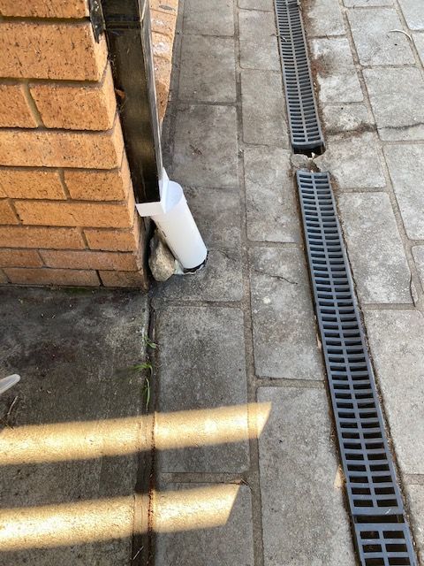

Hello everyone
Is there any adaptor available to connect downpipe to storm pipe. Please see attached image. It's little bit angle so straight pipe will not fitIMG_0376.jpg

Hi @kalradeepak,
There are adaptors for this purpose but they are fairly limited with the degree at which they can change the direction. Commonly you'll find them in 45-degree angles and the angle you need to achieve appears less than that. In this circumstance, you could try a Reln Stretch Ag Pipe 100mm Downpipe Adaptor. You'll need to check that the adaptor suits the pipe and downpipe sizing.
Alternatively, you would need to modify the bottom of the steel downpipe to achieve the angle desired. This would involve slicing up the downpipe with tin snips and then bending the sides to the suit the angle.
The only concern I have is, not only does the angle not look correct, the inlet in the ground looks deformed. Also, is there a reason for the stone behind the pipe?
Please let me know if you need further information or had any questions.

Re: Plumbing Connected Downpipe
Thanks @MitchellMc
I have put the stone to create that angle so water can go into the pipe. Yes pipe inlet in the ground is deformed but I guess in order to fix that I need to cut the concrete?
Hi @kalradeepak,
I think we would need to see a picture of how deformed the pipe is to provide an answer on how it might be fixed.
