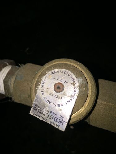

Under the floor my cold water pipe is leaking don’t know how to fix

 Hi thanks for your reply I just checked is not pipe but pressure limiting valve
Re: plumbing
Hi @patel,
If the pressure limiting valve has never leaked before then I would suggest that it is faulty and needs to be replaced or there has been a sudden increase in pressure within your pipework. It would be more likely that the valve has simply failed and needs to be replaced. I would advise contacting a licensed plumber to fix the issue.

Thanks, I’ll contact one tomorrow I’m in Wellington NZ how much cost to replace

I apologise for the delay in my reply. How did you go with the plumber? You might want to get a quote from a couple of plumbers to compare prices. The pressure relief fitting on its own will cost around $100 and then the cost of installation by the plumber on top of that.

No worries I got fix for $195 thanks
