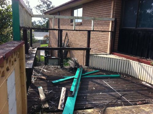

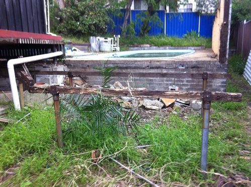

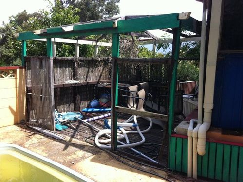

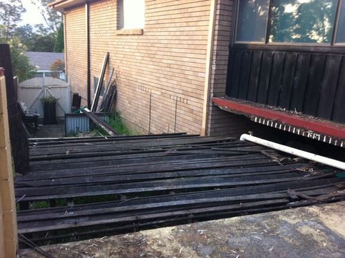

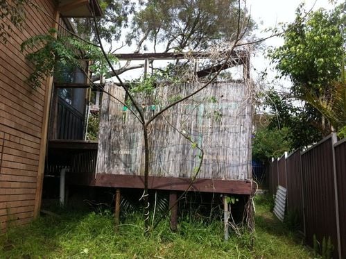

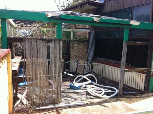

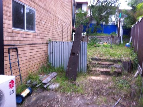

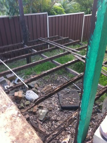

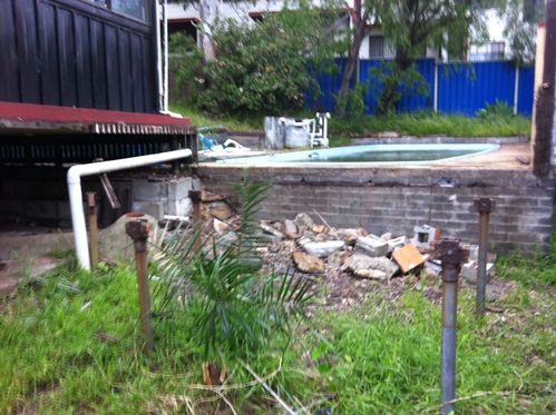

First steps were to removethe old gazebo. Once I started removing the sides and floorboards I was shocked at the state it was in. I was hugely shocked to find that the whole structure was supported on 4 steel pipe posts and then on just 75*45 joists... (Shaking my head)
Old Gazebo
Well and trully past end of life.
The underside with a couple of posts that rested on the ground.

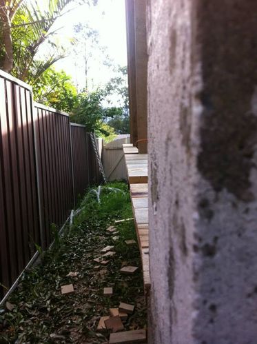

Removed and it really opened up the side yard.
Why do people always hide/leave rubbish underneath structures. It will come back to haunt someone.
Ahh yes the supporting structure...
Just a little bit of sag in the old floor...
Now I know why I was told "dont walk on it"
It was a pleasure to remove, hard work but I felt so much better afterwards.

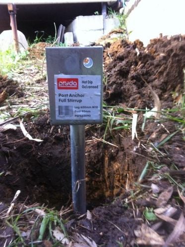

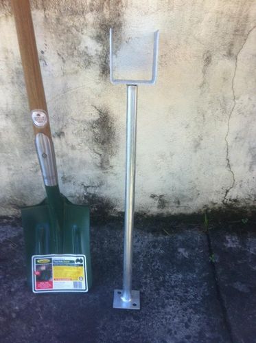

The stirrups I will use for the 500mm deep holes for the new posts plus my new shovel
That Shovel is still going strong 11 years later!

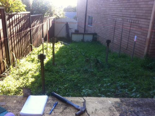

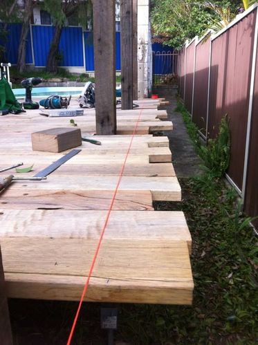

If you look closely you can see the stringline that is showing the new edge of the deck I want. I went through a few different iterations while dismantling the old one. My sketch pad really helped me work out what I wanted and how much quantity wise I needed.

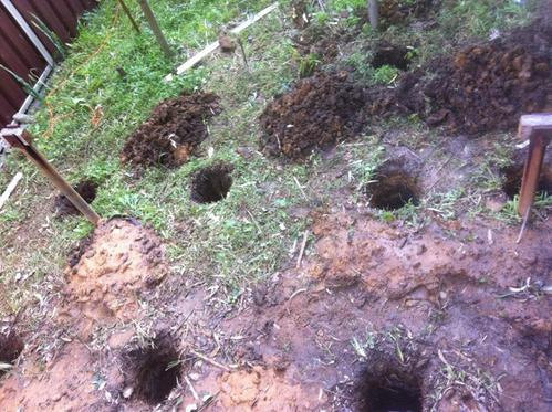

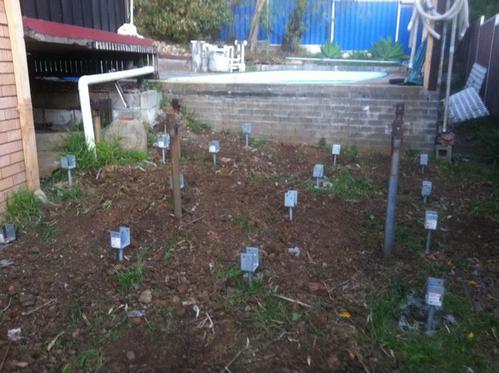

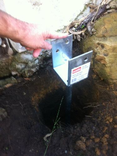

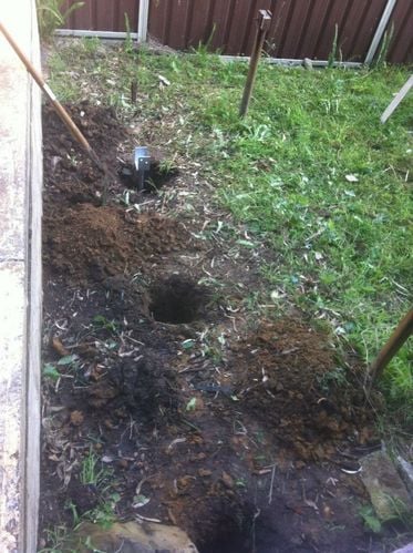

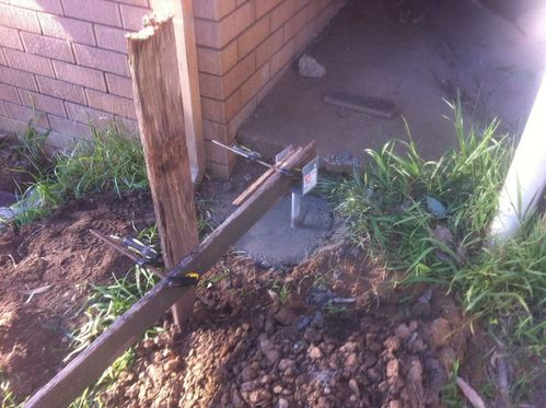

The next stage was to start digging the 16 post holes I would need. Only two issues came up. One the deck would be over the grease trap drop off point (and yeah Ive had to clean that out twice since) but managed to factor that in and the other issue was the post next to the foundaion of the house had to be moved a little so I could dig the proper depth hole.
Just checking the depth of the hole against the post

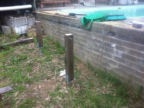

I really didnt want posts next to the retaining wall of the pool. I also didnt want to attach the timber to the brickwork as the old pergola had been. I think it really helped the old timber to rot.
Happy with the depth.

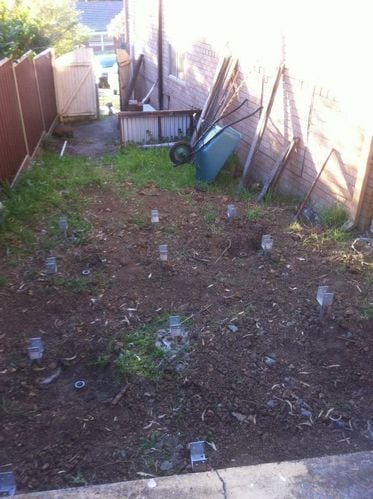

16 holes later....

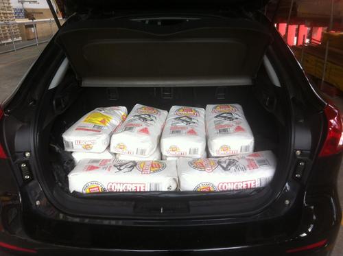

4 lots of 8 bags. Two bags of concrete per hole....

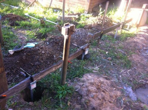

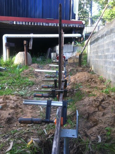

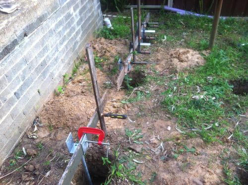

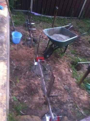

Lining up all the stirrups so they would be in a straight line, I wasnt particulary worried about the height of the above ground part of the post as long as 450mm at least was in concrete.
All lined up, was stressing like crazy as this was the first time I had used concrete anywhere and also the first time lining up posts in the same plane.

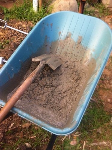

The cheapest wheelbarrow from Bunnings lol You do get what you pay for.... It lasted through the whole job until the second last bag I dropped into it and heard a loud "CRACK" It still worked but leaked from a 50c piece of plastic hole ![]()
Hard fast work as I was worried that the concrete would go off easily. Looking back I was a nubie ![]()
I just kept doing the next four and then the next..
This was the post with the issue of being next to the foundation. I worked around it.

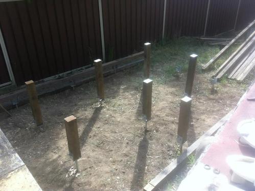

All done! Tho I need to buy a grinder to chop off those old steel posts.
Old steel posts are gone!

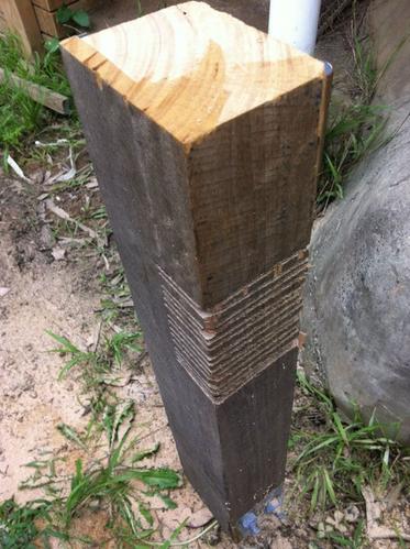

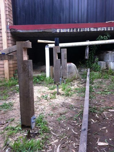

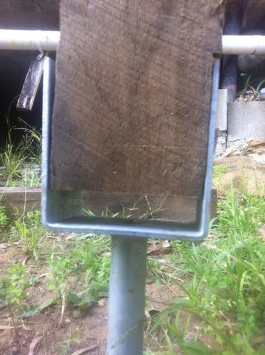

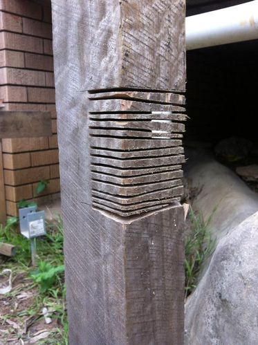

The posts were 100mm * 70mm? The 100mm had to be shaved down as the stirrups width was 95mm So another first with chiseling....
Just to show what I mean by the slight difference in timber sizing. I dare say if I used new timber it would have fitted straight up.
Once I had completed the first one, the rest came easily.

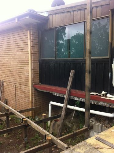

All the center posts were short as they didnt need to be the supports for the roof.
Outside posts being put into their sockets. I used other pieces as stays.
To help stop any swaying while I was installing them.

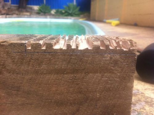

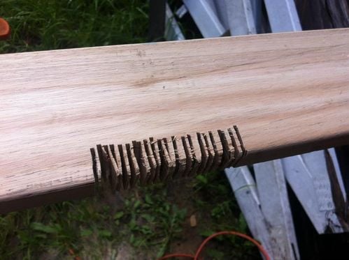

More chiseling and notching of the posts to support the joists.
I was feeling pretty happy with myself with the chiseling effort.

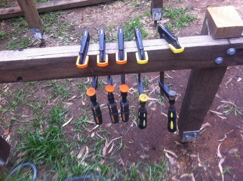

These clamps rock, they have helped me out so many times when an extra pair of hands were needed.

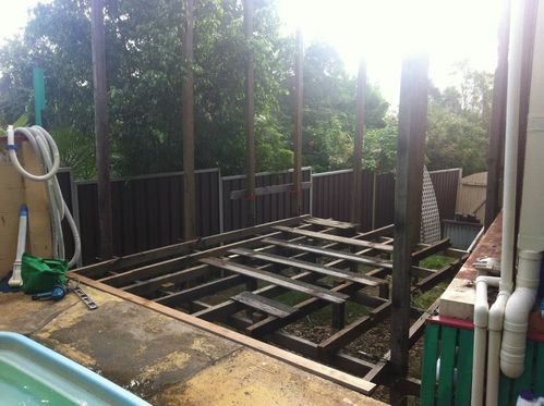

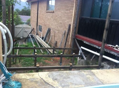

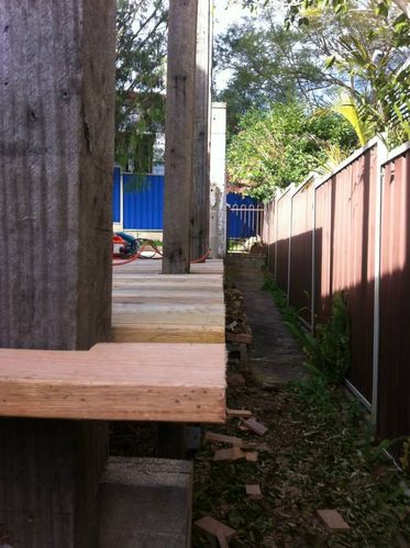

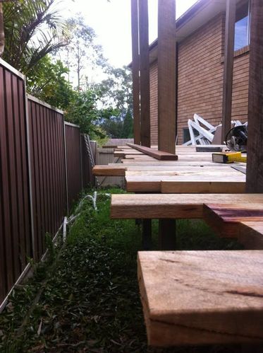

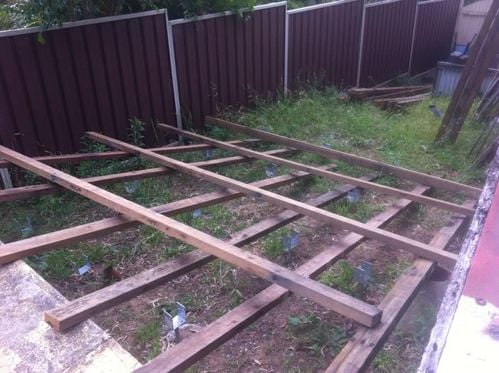

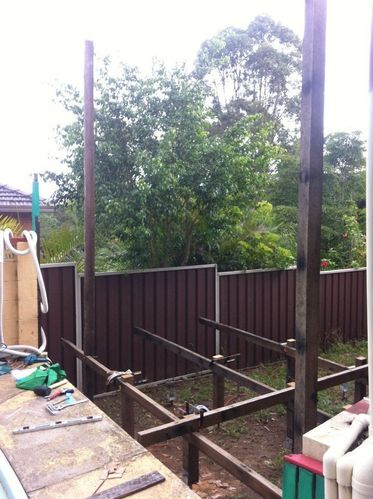

Slowly being built up, the joists will go across these.

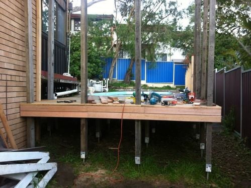

All the joists and bearers are in, they have lined up with the edge of the concrete of the pool so I was really happy.

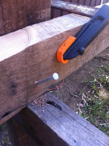

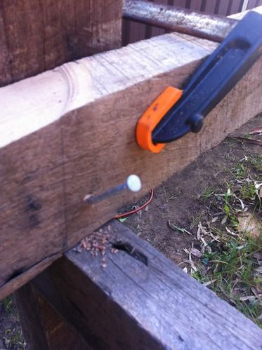

A couple of the joists had to be shampford as the concrete edge of the pool was not level (I was surpprised but shouldnt have been) I attached the joists to the bearers with 3" flat head nails.

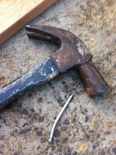

I predrilled the holes as it was hardwood.. It made life easier
But not so easy! I can still hear the ring of the hit of the hammer as the nail went into the timber, it went up in pitch the further it went in!

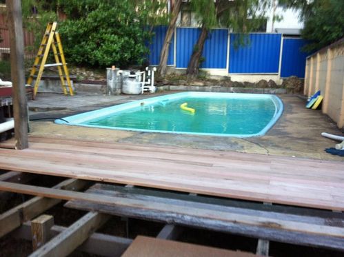

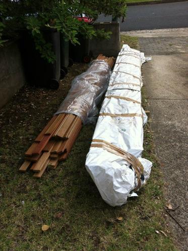

Decking has arrived!
And for the life of me I cannot remember the type. I know I got it form Waxwood is all, the privacy screen was jarrah as I wanted the red colour and width of the timber.

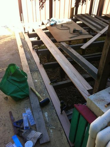

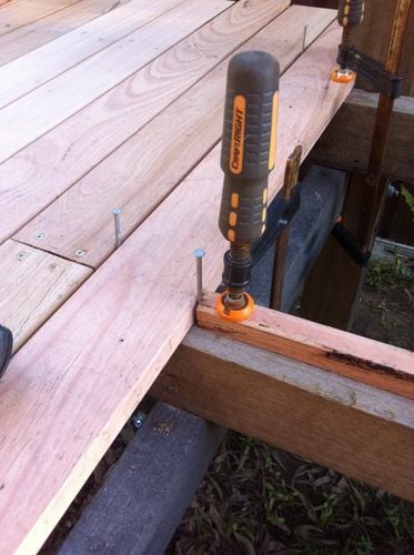

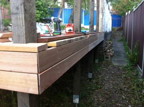

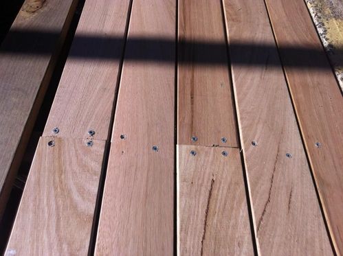

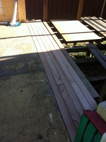

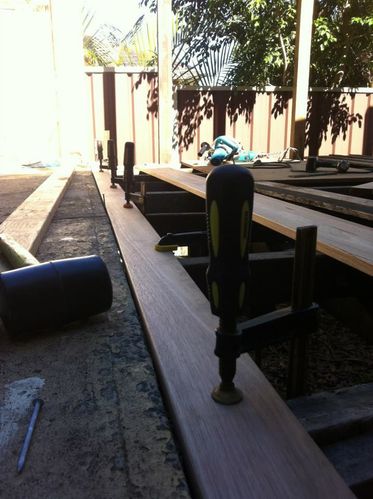

I used the 3" nails as spacers between the boards and then used G clamps to hold theboard straight (with the help of a mallet) before predrilling and countersinking the holes. Then just worked myway across the area. I made sure I staggered the boards and also kept in mind to place the screws the same way across the timber.
Lining up the first piece of timber to go down next to the concrete. I was a little nervous about getting it right and accomodating the slightly different levels.
It worked out, The first one took a little fiddling but then it was easy to roll through them.
Have to say the little green ozito drill absolutely rocked! I used it to put all the screws in for the deck and privacy screen and it worked a dream.

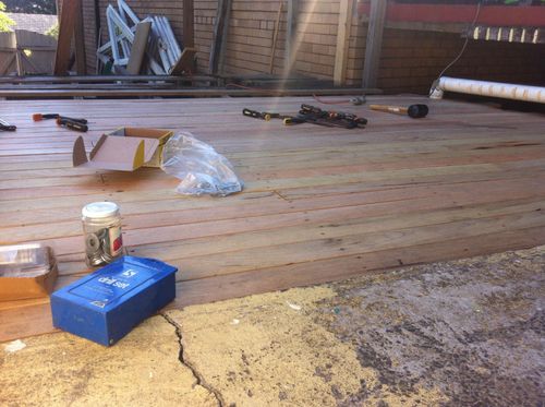

First days effort done! And yeah I would sit on it and just admire the timber lol

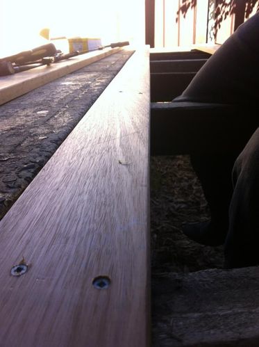

This is what I was refering to in keeping the screws inline. The same diagonal spacing except for when two pieces butted up next to each other. Tho looking at that maybe I should have kept them all straight? Mmmmm
Slowly moving across the framework.
Sometimes I had to come up with inventive ways to straighten the boards before screwngthem down. The nails are shown as spacing for between the timber pieces.

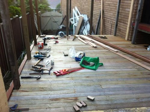

I had a lot of fun building the deck, stessful at times but so much fun overall.

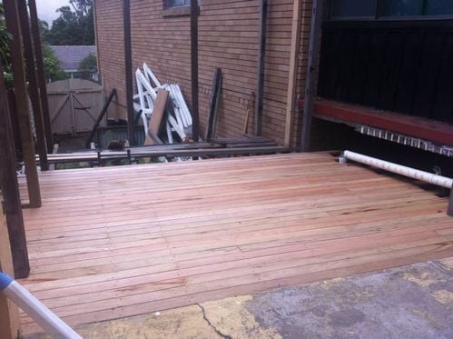

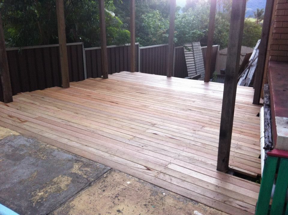

Almost there! And now it was time to start stressing about how to do the edge and then the privacy screen.
Flat area all decked out!

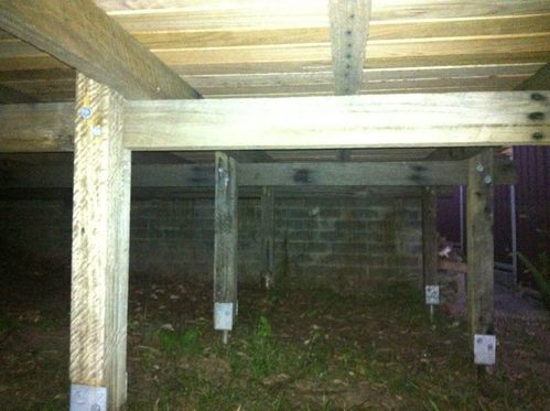

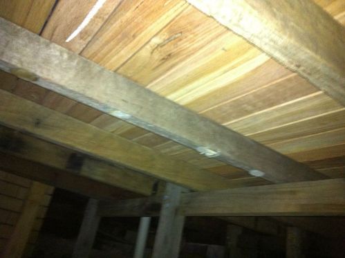

Underside, really happy with the look.
It feels safe underneath even with all the weight above.

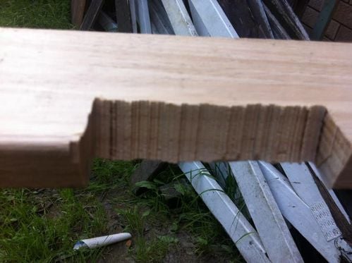

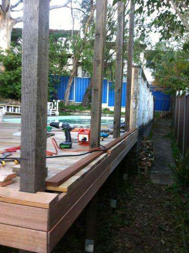

Notching the edge piece of timber to make it look pretty
Maybe not the right way but its how I figured to do it. It worked out pretty tidy.
It worked out great ![]()

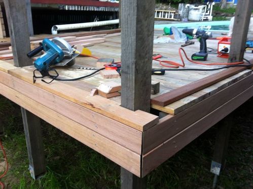

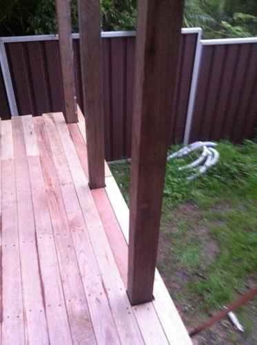

Now it was time to square the edge up and put the skirt on. I hadnt done anything like this before and definently hadnt done a join cut for a corner so was fairly nervous about making mistakes. I just told myself to go for it and if I had to buy more timber then thats the way it had to be!.
All the pieces of timber came past the edge that I wanted so it was a matter of putting down a straight line and cutting it with a circular saw.
Working it out, There is something about working with timber I find relaxing. I remember stressing over doing the straight cut all at once. It turned out to be easier then expected yet again.
And cut! The last piece I had to do by hand as the concrete wall was in the way of the circular saw. It felt so nice to have a straight edge.
Other way.

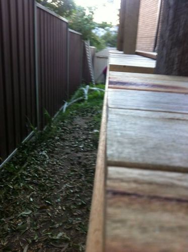

Because I was taking so long doing the job the timber colour had started to age and change. I really should have oiled it as I went. Or found time to do it 6 weeks after laying it each section.
The skirt is on!
Really happy with the edge. I can hear my internal cheering as I was surprised it had worked so easily!
I was supper happy with the corner cutting. I didnt have a drop saw back then so I would have angled the circular saws flat plane to get the angle right. Its not the best but was well above my expectations ![]()
