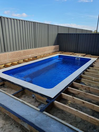

Create a border around the pool using those which means some will be bearers and some will be joists.
Then continue the rest of your frame with the H3 timber you've planned.
This photo should help show what I mean.

@ProjectPeteWhats the black stuff on the H4 sleepers ? Just the normal water proofing tar stuff or something different.

I trust @ProjectPete will let us know what the black coating is. I suspect it is a bitumen-based product similar to Bondall 1L Inground Timber Protector, used for extra protection where pool water might settle upon the timber.
