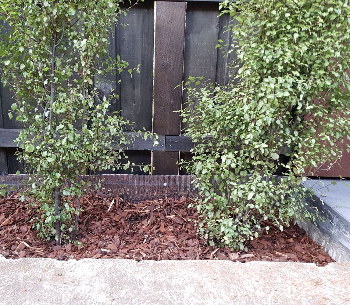

We finally got around to finishing the garden bed last weekend. Here's a snapshot of the edging we used along the fence. Thanks again for your wonderful advice!
Re: Protect fence from rot
@EV77,
I'm glad to see that worked out well for you. Not only does it serve a purpose it looks fantastic too.
Many thanks for sharing the finished result with the community. We look forward to seeing what your next project is around your house and garden.
