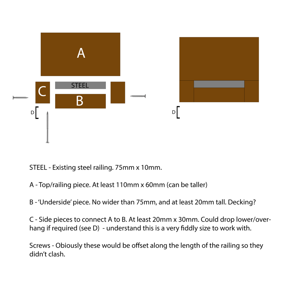

The key challenge I'm facing is how to attach timber to the top railing, ideally without needing to drill into the steel. In theory I can achieve this by 'wrapping' around the steel. (See rough diagram / example photo below). I'd love some advice on how I'm planning to go about this.
The steel railing is 75mm wide and 10mm thick.
My concept below would require:
- Large 'railing' timber on top. At least 110mm wide and 60mm high.
- Thin timber, screwed into the bottom of the 'railing', to connect the railing to the timber underneath steel.
At least 30mm H, 20mm W. (wouldn't be too fussed if there was some overhang here if that's too small)
- A piece of timber beneath the steel (eg. a decking board), 75mm wide and 20mm high.
