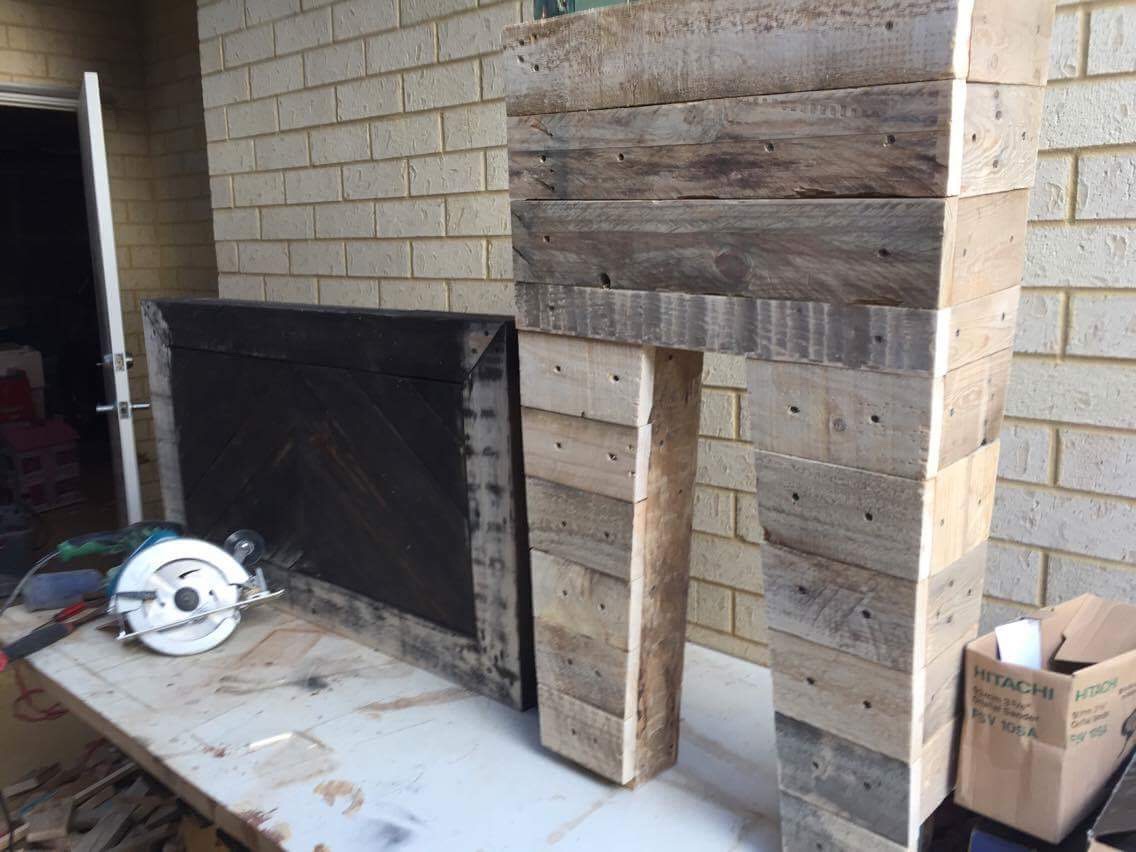

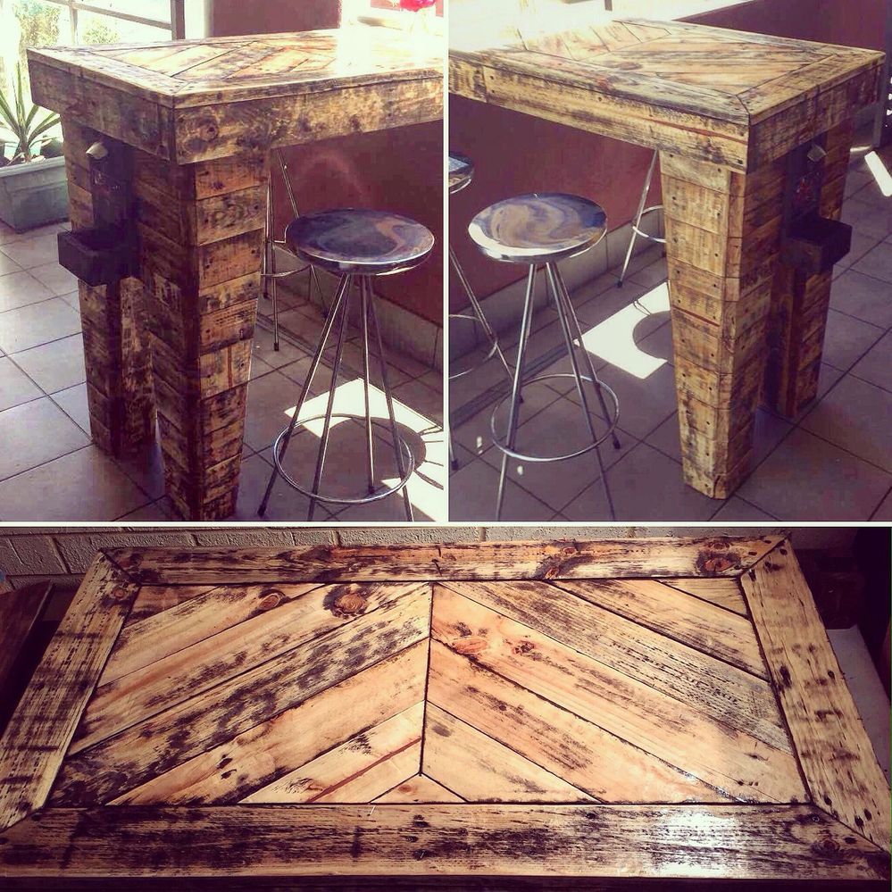

Here I have made a beakfast table bench for a mate that has a small balcony. I have just ran the top of table off the fixed wall/fence and installed 2 legs.
This was a fun project as there were a few things I have done different here that I haven't done before and worked out nice. One of them is the legs, Instead of doing plain square ones, I wanted to make them go fat to thin, then I some how thought of putting a 30degree shamfer on the edges with a circular saw.

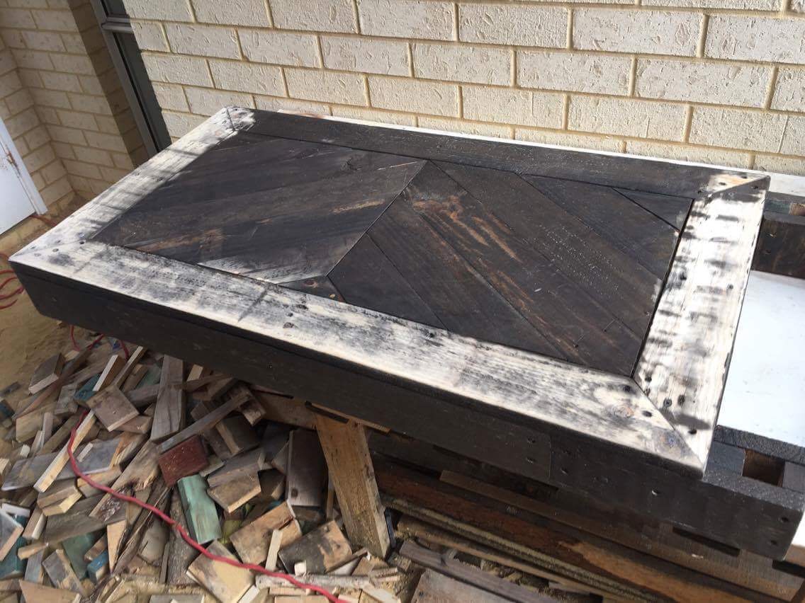

Another was the actual stain itself, I originally stained the whole this dark brown but I'm glad my mate wanted to change it to a more rustic light look so I got the belt sander out and went to town. As my stain was my Vinager & Steel Wool method, after I sanded parts back, the clear coat varnish had reacted nicely to give this final product the look.

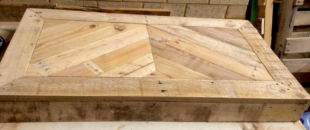

the first sand, I wish I had a Thickner or a table saw Just sanded

IMG_0800.JPGas you can see here, after I realised the stain was just to dark , my aim was to sand back as best I can, once I for the whole top looking like the border i applied a clear Coat of Cabothane Clear Varnish, it gave me the finish that it did. I had no idea what it was going to turn out like
