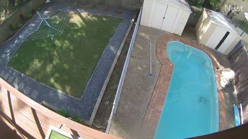

I've been thinking about refreshing my pool area which has started to show its age.

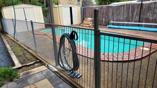

Current condition:
*the pool fence is falling apart and
*the pool coping has pieces which are coming off.
*The aggregate concrete has showed signs of settling.
*Sheds are pretty much rusted out
Potential plan:
*install low profile alluminium decking sub frame
*with the composite decking for decking material.
*Get rid of sheds (already have plenty of storage for outdoor tools)
*Frameless glass pool fence
*Get rid of pool water feature
What are some thoughts from the group around this plan? Or any better suggestions. Budget is a moderate concern. I'd like to DIY as much as possible.
Thoughts on what to do with pool coping? Would I be able to remove the coping and deck up to the border?

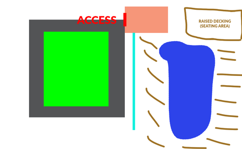

Actually the second picture is exactly what I had in mind.
