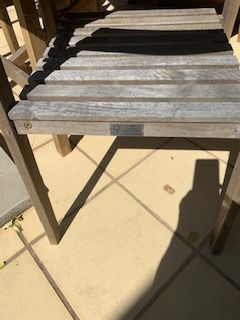

Dear Bunnings,
I have Mimosa outdoor furniture (Honolulu) that I purchased from you about 2 years ago. Table, 4 xchair, bench, sun-lounge. I would like to clean them up and make them look brand new. can you please give me advice of what i need and how to do it. I am 70 years old, so nothing strenuous. Or better still, do you provide a service that will handle this job.

The setting has received a fair bit of sun and you've likely skipped some seasonal oilings. It could do with a light sand to restore the timber colour before re-oiling. I understand that is a lot of work and the next best thing would be to scrub it down with some Intergrain 1L UltraPrep Timber Cleaner. Once you have cleaned it down with the UltraPrep you can use a furniture oil on it to nourish the timber. This oil should be applied yearly to avoid the timber becoming grey, dried out and eventually cracking and splintering.

You would give the furniture a light sanding with a sanding tool or by hand with a sanding sponge. This would involve several hours worth or sanding as there are many intricate spots to reach. I would consider this quite strenuous work. Personally, I would advise using the UltraPrep product first and seeing how well it restores the colour of the timber. You can then either choose to sand it back further or simply coat with an oil.
It's borderline needing to be sanded at the moment, that is why I am questioning whether it is worth the effort. If it was starting to splinter then you would definitely need to sand.
Perhaps us the Ultra-Prep product and then post some additional images for us to have a look at.

I have noticed some splintering, so I think I will have to sand. One of your contributors suggested contacting Mens Shed. I have sent them an email about someone doing the job, but reading the advice again, it looks like I would have to get the furniture there. Looking at what has to be done I think it is best for me to get someone to do it, but thanks to you I know what products are required.
