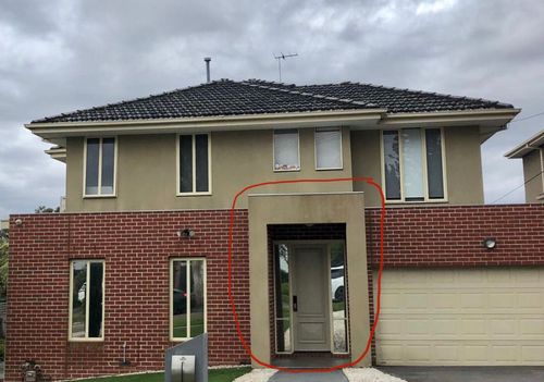

i am planning to refresh my not very attractive exterior wall/pillar (See attached photo), can someone give me some advice on what product I should use? Much appreciated for your help

It looks from your photo that wall is rendered brick or blueboard. Can you please confirm? Also, are you wanting to match the colour of the render on the second storey of the house? If so, do you know what the colour is? Or are you looking to perhaps change the colour?
Also, do you know what is causing the stains we can see on the photo?
If you could please confirm I would be more than happy to tag members to assist you.

1.yes I believe it is blueboard
2. Would like to match the colour, or similar
3. not sure what caused the stain, might be rain water dripping from the metal?
Have you considered a timber/bamboo/fibre cement/composite cladding to create a feature for that entry way rather than paint @kev_au? It would also overcome the issue of future staining 😊
I'd suggest that it is possibly due to rust tainted water from the metal and I like @ProjectPete's idea of some type of cladding to disguise it. In answer to your question about what product to use, I can recommend Dulux Weathershield Render Refresh which is designed for this purpose. It is available in a variety of colours and more information can be found about if on the Dulux webpage. In regard to matching the colour, you would either need to take a sample of the render in to be colour matched or go through the available colours in-store and take a few sample pots home with you.
