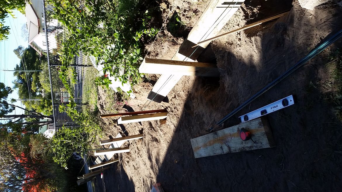

Retaining wall in progress.
MandaH
Budding Contributor

Thanks @Jason. Yes, this is the front garden. Plan is 600mm high, pine sleeper retaining wall.

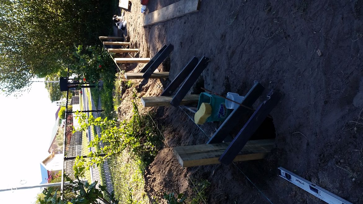

20170608_093218.jpgholes 600mm deep.

20170608_145334.jpg2 bags of rapid set per hole.

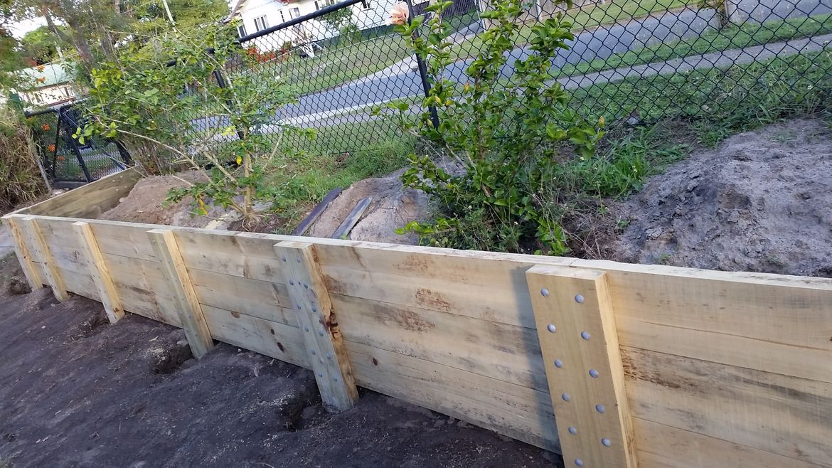

Put drainage fabric, a slotted socked agi pipe and a tone of drainage gavel behind wall before back fill.

Looks great! Thanks for the update @MandaH.
