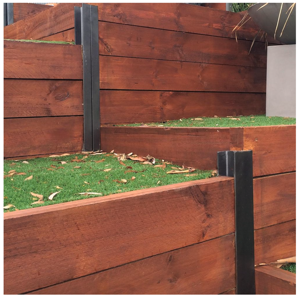

I'm aiming for a straight line version of:

I received my delivery of Ironwood 200 x 75mm 2.4m Sienna Treated Pine Sleepers, but they do not appear stained as illustrated. If anything, they are beige with a green hue. I am wondering if these can be stained and if so what stain would be recommended. I'd be looking for something that would stain the sleepers into a colour like that depicted on the website (see below).
Re: Retaining wall with Whites Retain It system
Hi @steveof2620,
Typically, because of the treatment of Sienna sleepers, they have a red-coloured hue. I'll reach out via private message to get your location details so I can investigate further.
The sleepers can be stained, but I'd like to double-check your order to make sure that you've received the correct product.
