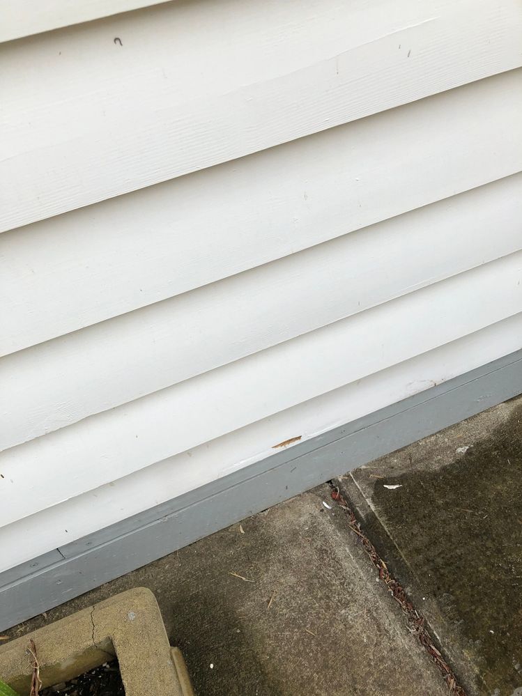

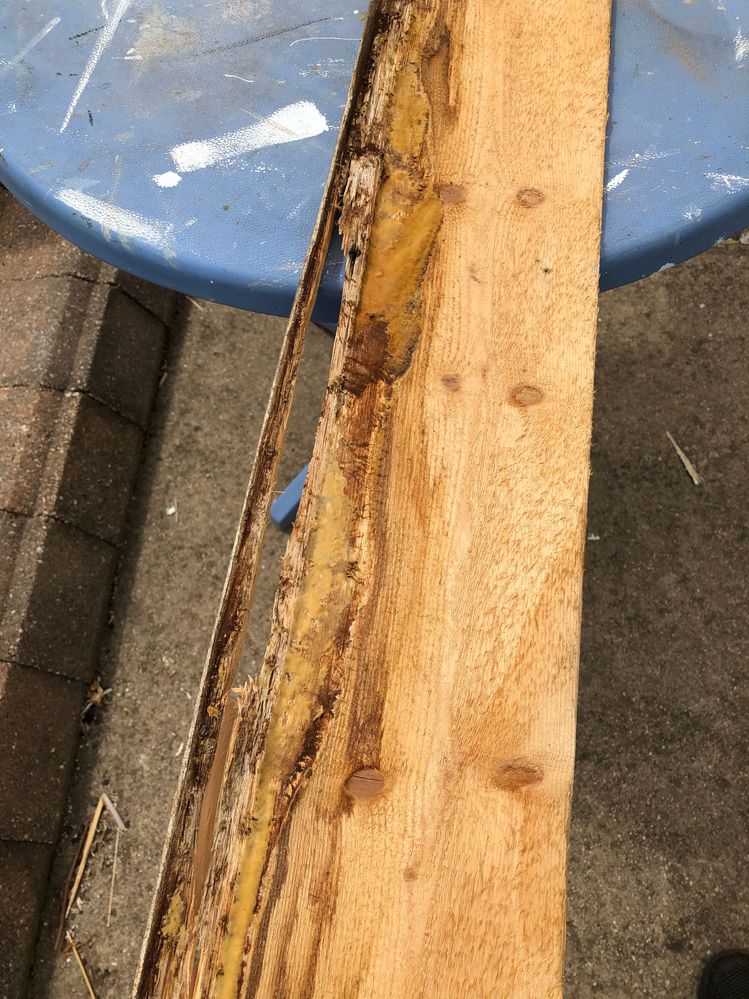

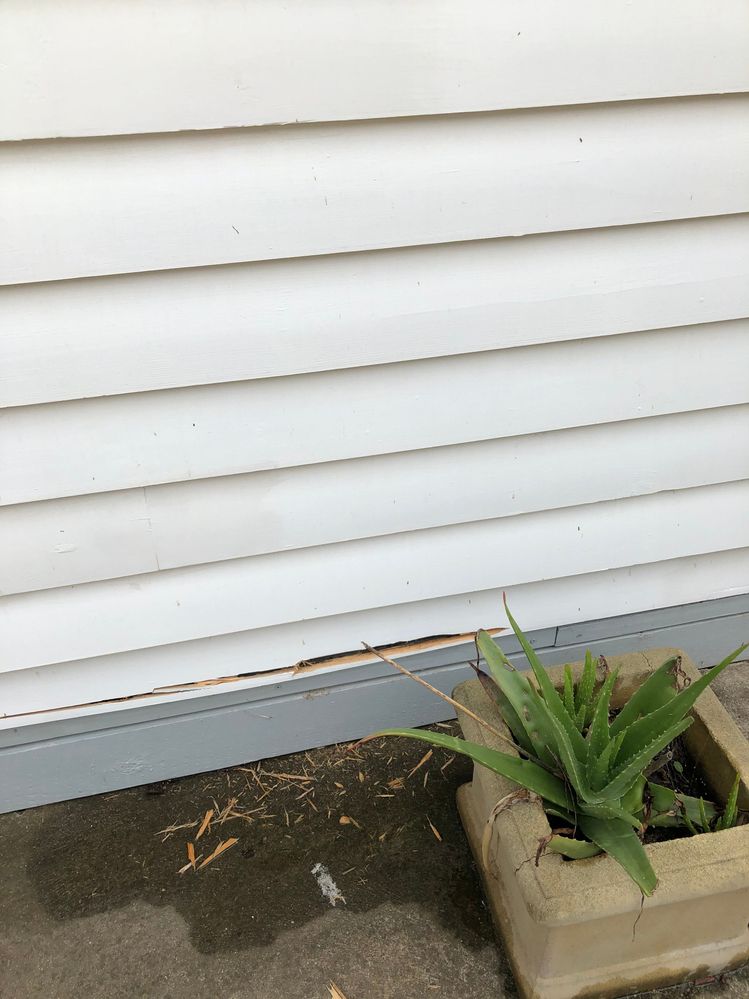

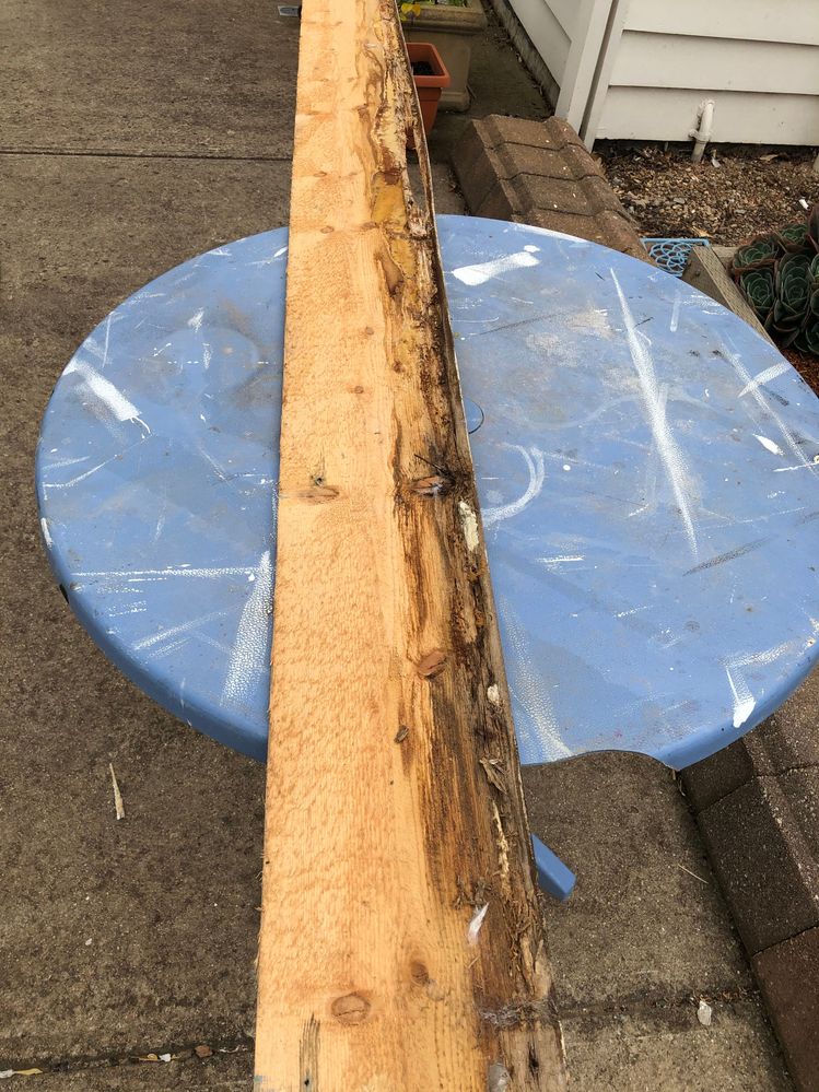

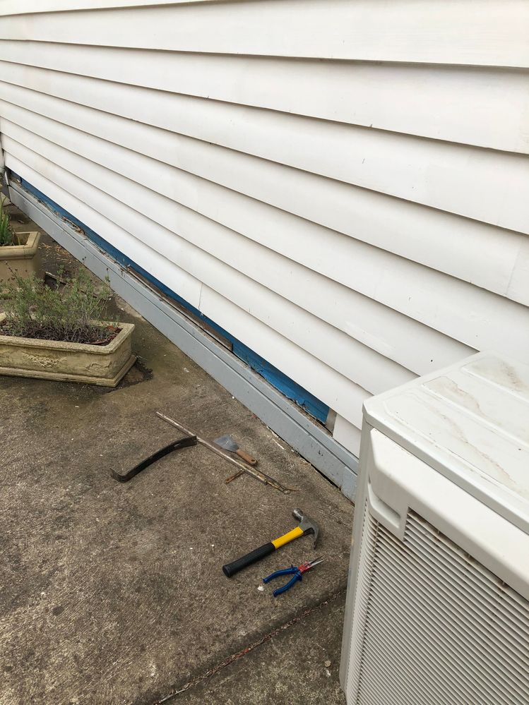

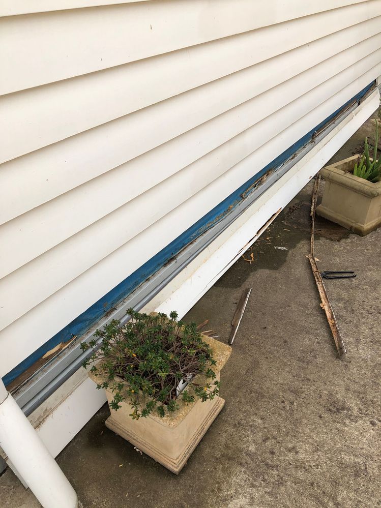

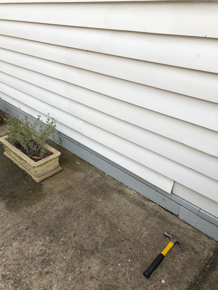

Whilst I was watering my plants on Valentines day, morning, I noticed that one of the lower weatherboards had a small lineal depression on it. I decided to push it in with my finger nail and it was a rotted weatherboard. I decided that I would clean it up and fill in the damaged area. As I started removing the rot, it got worse, luckily I have some spare weatherboards, so I decided to replace the damaged one. When I removed the weatherboard, there was more damage that could be seen on the face of it.
I also left a gap between the base board and weatherboard to allow any water to run off the weatherboard.

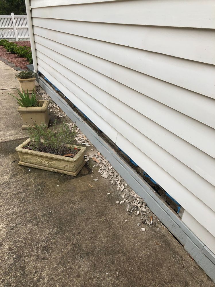

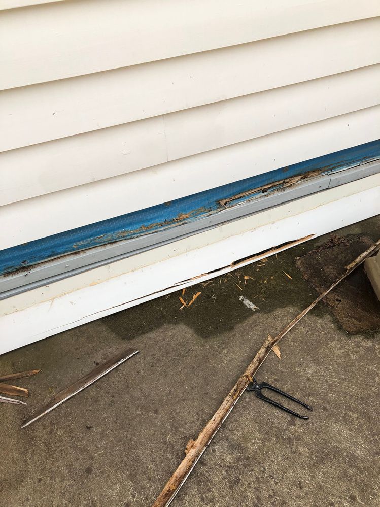

Cleaned up behind weatherboard, remnants of lath and plaster
Found these behind weatherboardFound these behind weatherboard

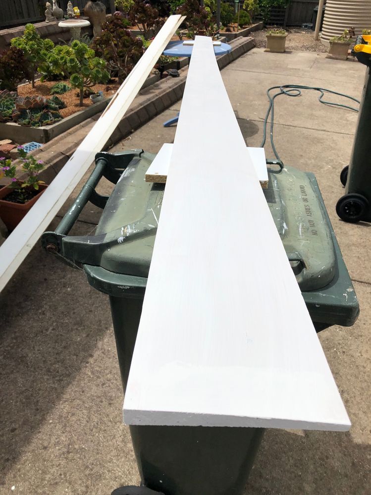

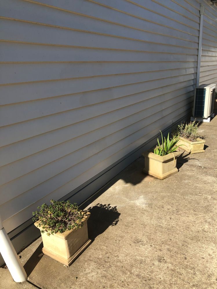

DBWD5523E.JPGFXXT0234G.JPGNew boardNew board
