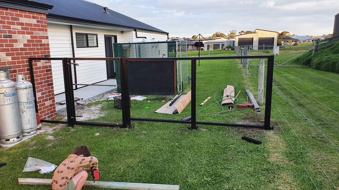

We haven't long moved into our new house and one of the jobs on the list to do is the front fences.
My wife and I seen this style of fence a couple of times and wanted to incorporate it into our place.

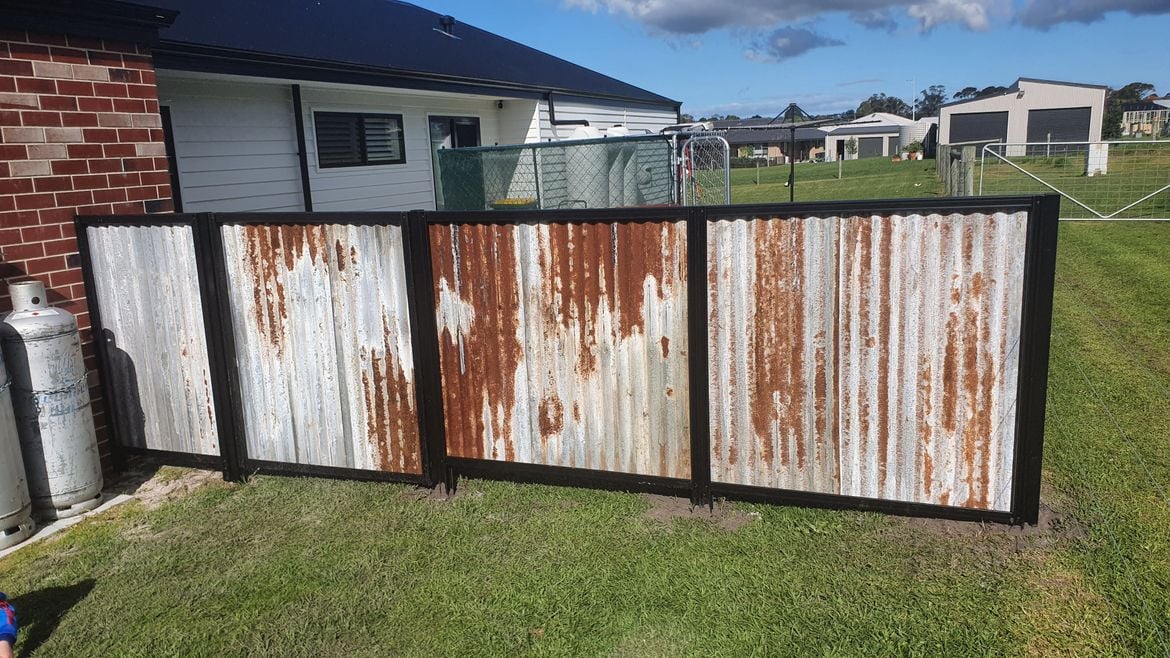

Basically all I used was just standard colorbond fencing post and rails then hunted down some rusty old corrugated iron.
I also used some 50x50 tube on either side of the gate and boundary side.

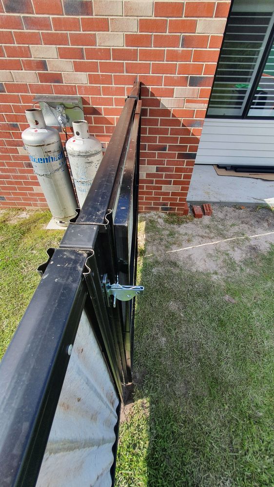

The gate was just a Rapidmesh adjustable gate frame from Bunnings that i painted black and screwed the fence panel to it
I have read that the hingers on these are not the best and can brake the welds but ill deal with that if it happens later.

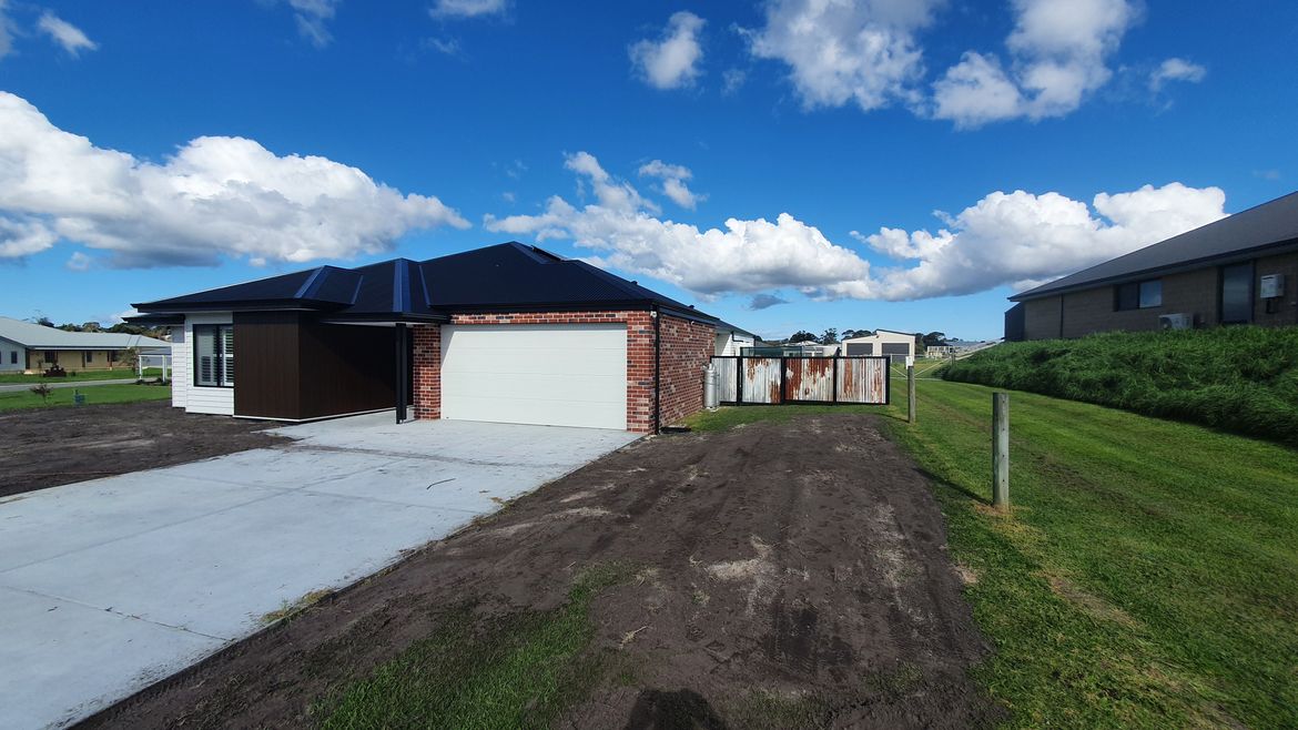

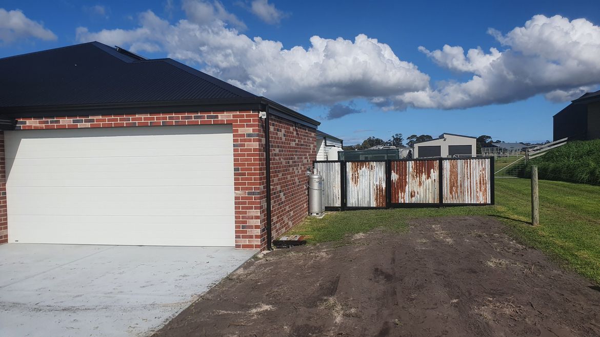

I think it turned out really well. once we get all our native plants/trees going it will all tie in really well.
