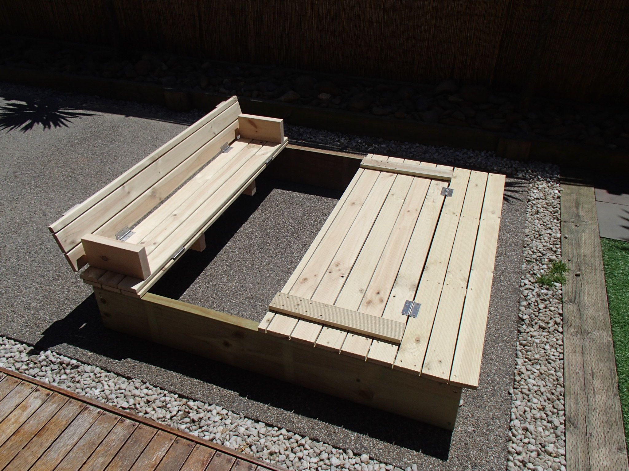

I just have this picture at the moment of one recently made, didn't have any handles fitted at the time of taking the photo. I use decking for the lid/ seats mainly for strength, once closed i can stand on it and the kids can walk and jump all over it. The blocks of wood you see sticking up on the seat and below work as braces, when closed they are in contact with the sand

I haven't built one of these, but from what I can tell, the basic premise is to join four lengths of treated Pine sleepers with coach screws. You'll then cut six lengths of treated Pine decking and fix them across the structure with treated Pine screws. Layout three more lengths of decking on either side. A piece of sleeper joins together these two sets of three lengths at each end. Use two hinges per side to join these sections together. Two or more additional lengths of decking are then laid out to fill in the remaining gap. These are held together by two lengths of 90 x 45mm treated Pine framing timber on both sides. They need to be long enough to engage on the sleeper, forming a backrest.
I'll include some images below, which might help further explain the steps.
