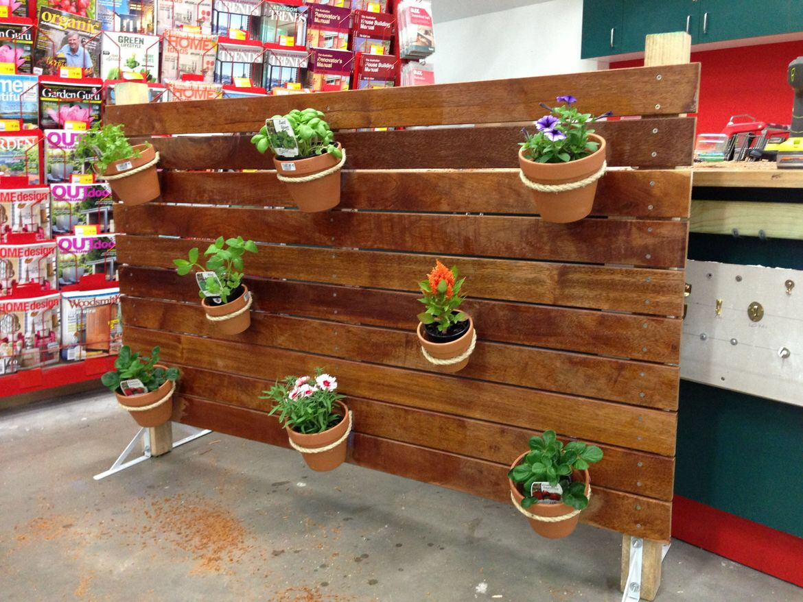

This is something I put together in the DIY workshop because I had a fair few people asking about screening ideas.
After building the structure and placing the decking timber in position, I simply placed 2 holes side by side into position in the boards, ran some rope through the first hole knotting the end, and tracked it around the lip of the terra-cotta pot, and back through the second hole and knotted it at the back.
I would also recommend irrigating and putting it on a timer for those that are time poor. The irrigation lines are well hidden because they can poke out from between the boards and enter the pot from behind.
You could also paint the pots to add a pop of colour. Have fun with it.
