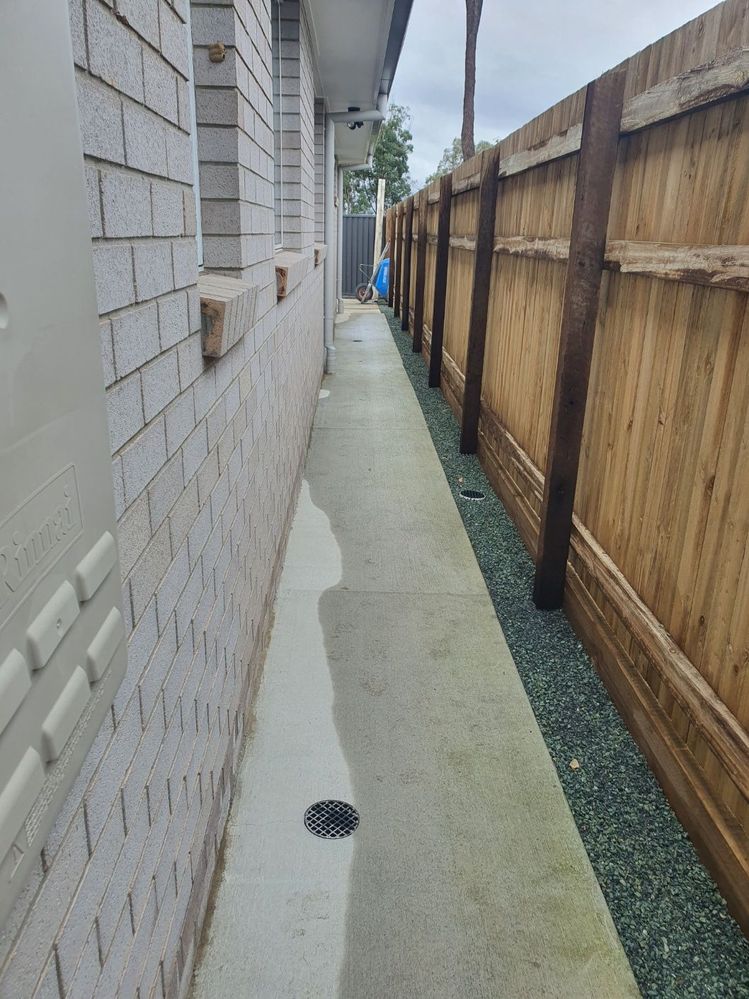

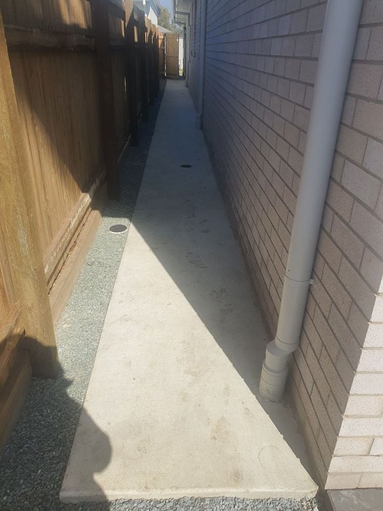

The concretes footpath is 19mx0.9m and 5cm thickness, attached to the house without the expansion joints(expansion foam) and contral joints. On the top of this, the concretes footpath was installed sloping towards the house so the water/rains sit there, not sloping away from the house.
Weep holes and damp proof courses are located on the wall 18cm above the concretes footpath.
Do you think that I should remove this concretes footpath and place pavers and gravels after leveling on the ground?
Or can I place the waterproof membrane or other waterproof products over the concretes and place pavers and gravels after leveling with sand?
I am trying to find the way to fix my footpath with the minimum costs. Removing this concretes footpath and re-installing the concrete footpath properly costs me $7000. (I have got a quote yesterday).
The tiling over the concretes with slope would cost me around $3000. But it would be slippery when rain comes or might get broken easily if I drop some garden tools on the tiles. So I don't want to put tiles.
I think putting the pavers and gravels might be the best option to reduce the costs and have low maintenance. But I don't know about landscaping much. I always lived in the unit. So please give me the tips or advise.
Would it be ok to place pavers and gravels with waterproof membrane or waterproof products over the concretes or should I just remove the concrete footpath? I am concerned about water drain as well when I place the pavers + gravels × waterproof membrane over the concretes.
