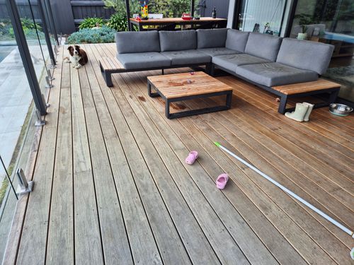

I have 3 decks of different sizes that I've neglected for a few years. I want to give them some attention, sand them back (if needed) and give them a clean and oil.

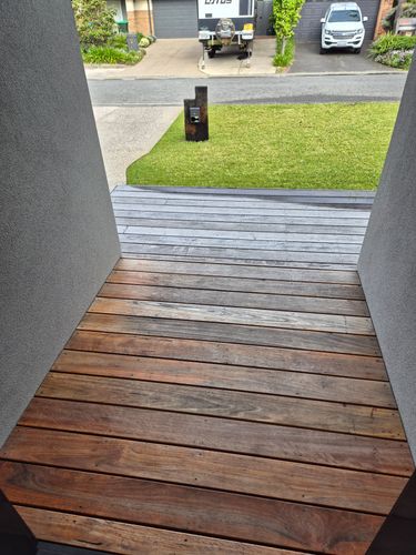

First deck is my main deck.. has had an oil a few years ago but is greyed off in areas that get sun and starting to cup. I've also spilt paint in various spots. About 40sqm.
Another deck is my spa.. never had any oil on it. About 4sqm.
And last deck is my front deck.. was oiled a few years ago. Seems to be getting dirty in the exposed area. About 7sqm.

Yes, sanding your decks will make a big difference, especially since they have uneven wear. If you were to clean and reoil them as they stand, it would be uneven across the different wear areas.
For your main deck, a full sand-back is the best option to bring everything back to a clean slate and even out the different wear patterns. It’ll remove the grey surface, flatten cupped boards, and strip off any paint, giving you a clean base for oiling.
The other two decks are quite weathered, and they would also benefit from a good sand before oiling. This will ensure the grey weathered timber is removed and you don't have irregularities because of it.
Before sanding, you'll want to give your deck a good clean to ensure you are not sanding dirt and other contaminants deeper into the timber. Check out How To Clean a Deck for some guidance.
