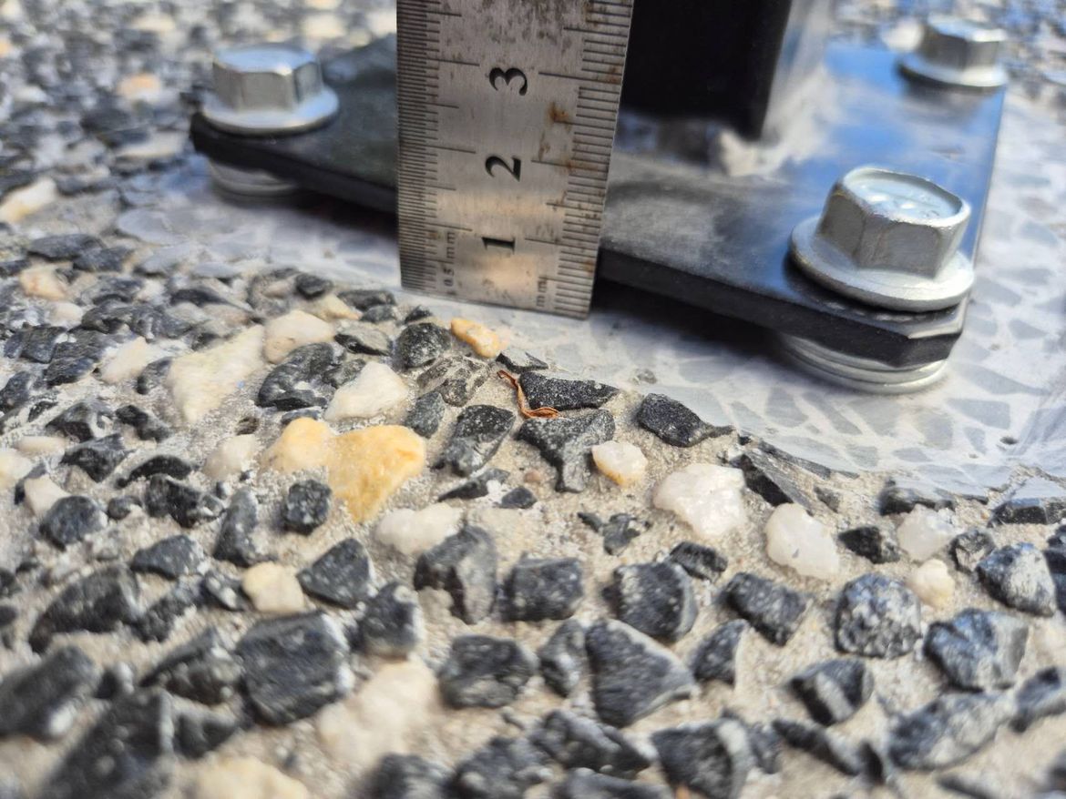

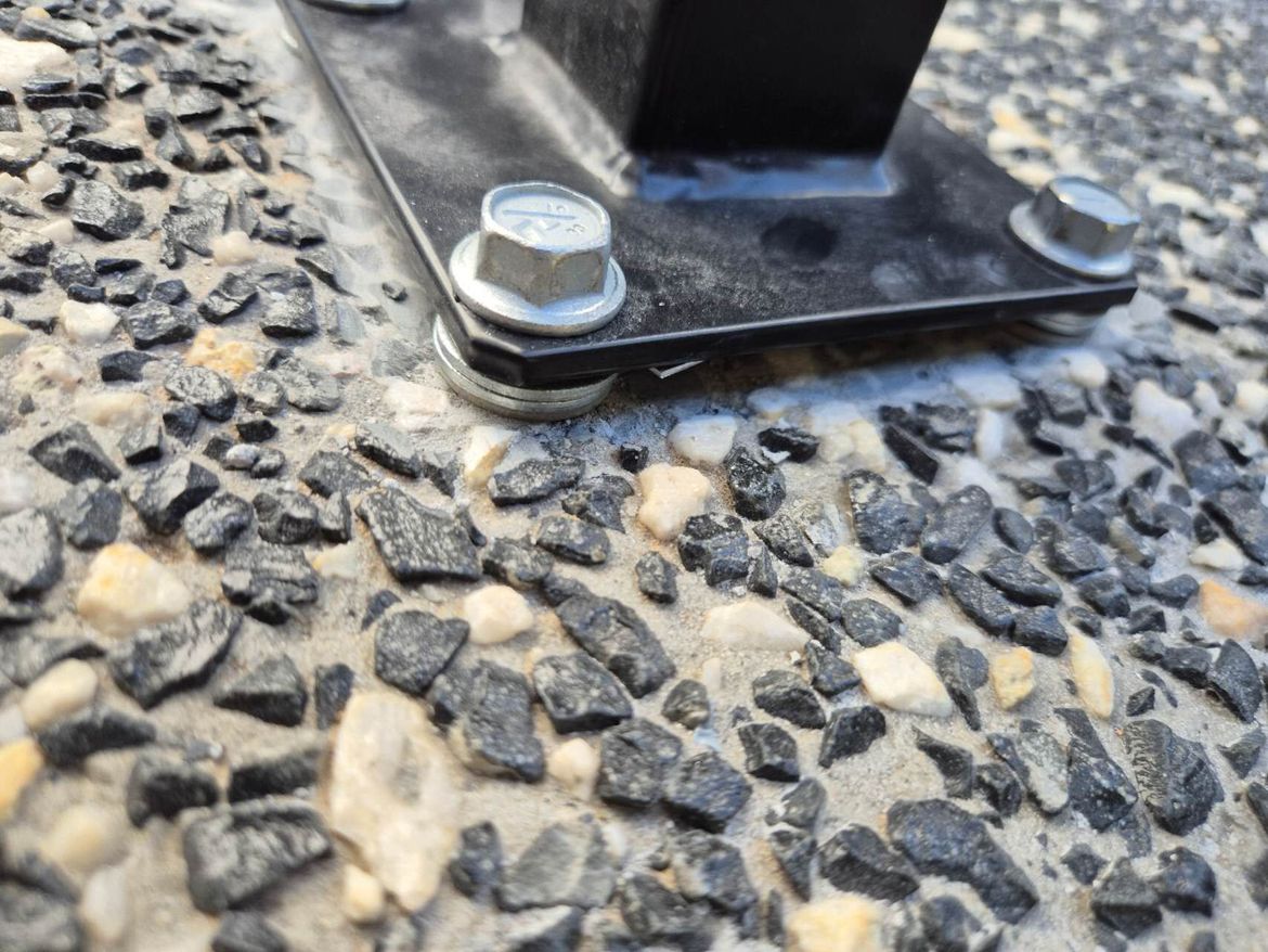

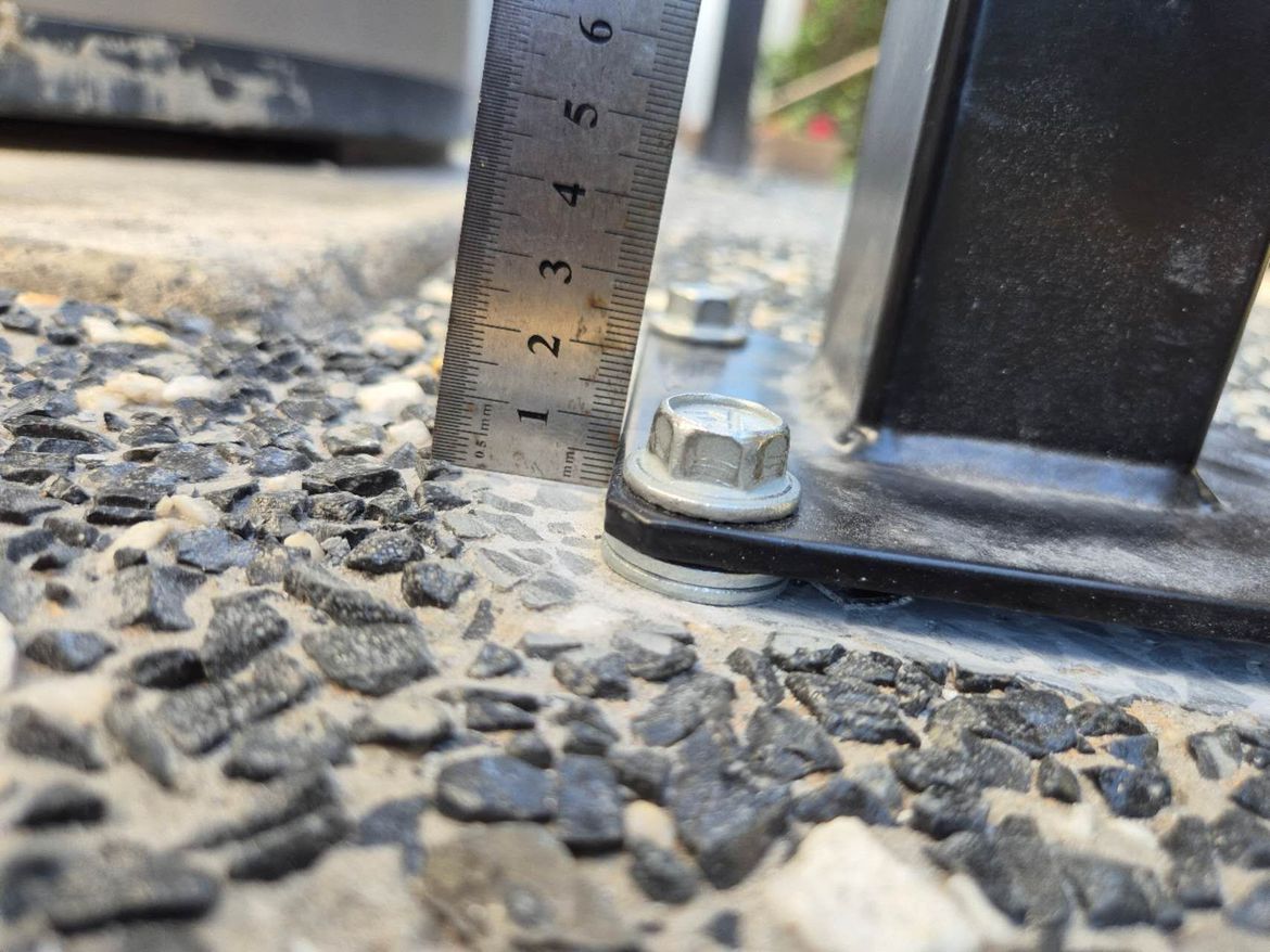

I have secured some decor screen posts to my exposed agregate path. There is a gap between the post foot and the path because washers are used to ensure posts are plumb.
Is it a good idea to seal the gap with silicone or better off to leave it open.

Thanks for sharing your question about your post footing. I vote leaving the gap to allow water to escape should any find its way there; it also allows air to pass through which promotes evaporation. Since you've used galvanized fittings, it should be able to withstand inclement weather.

Unless it’s an eyesore for you it would be safe to leave as is. Otherwise you could run a bead of black silicone around the outside which would cosmetically have a cleaner finish. This would be more preference.

Id also vote with leaving it open to allow drainage and air flow ![]()
Nice job at leveling the posts ![]()
