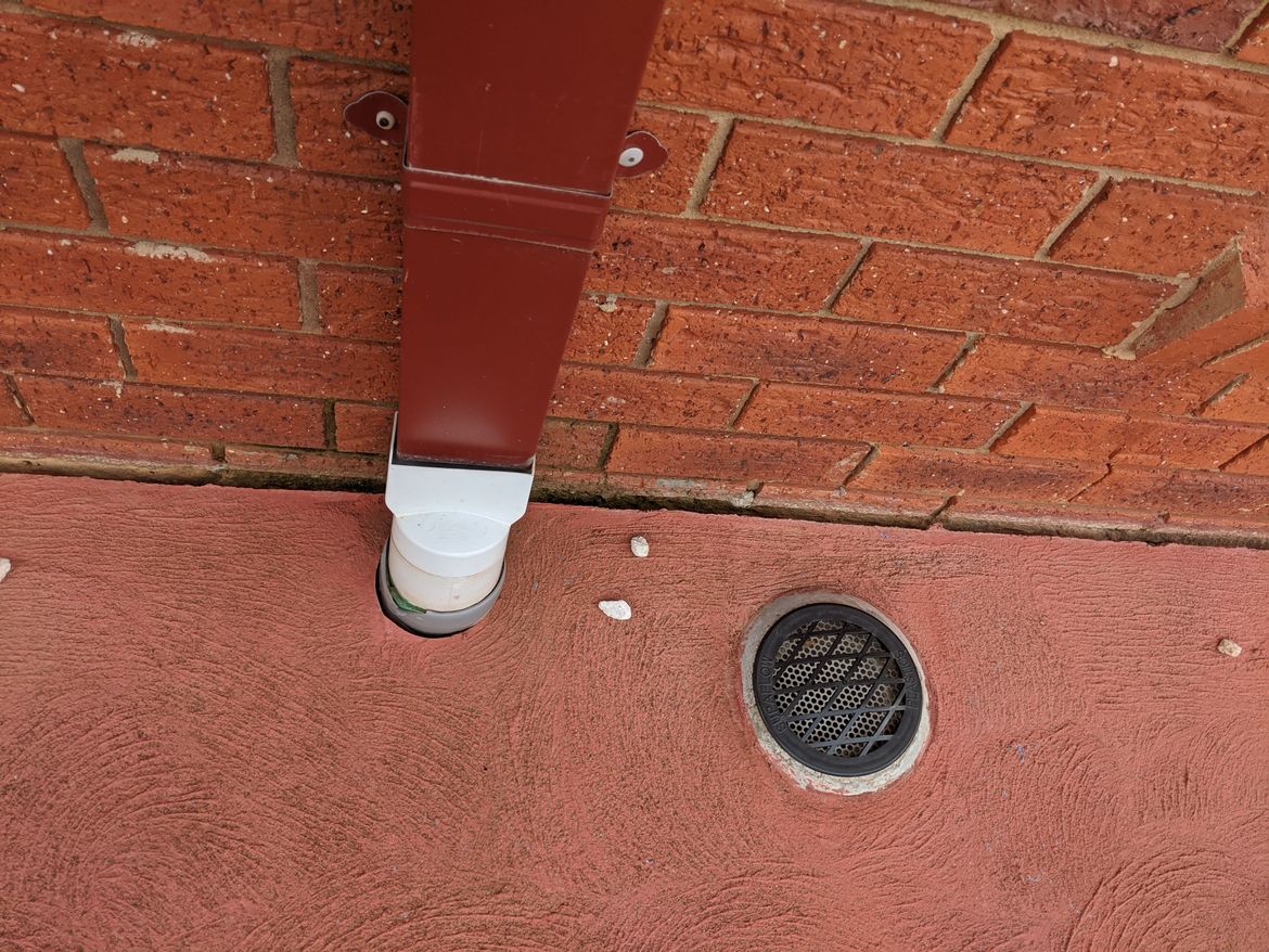

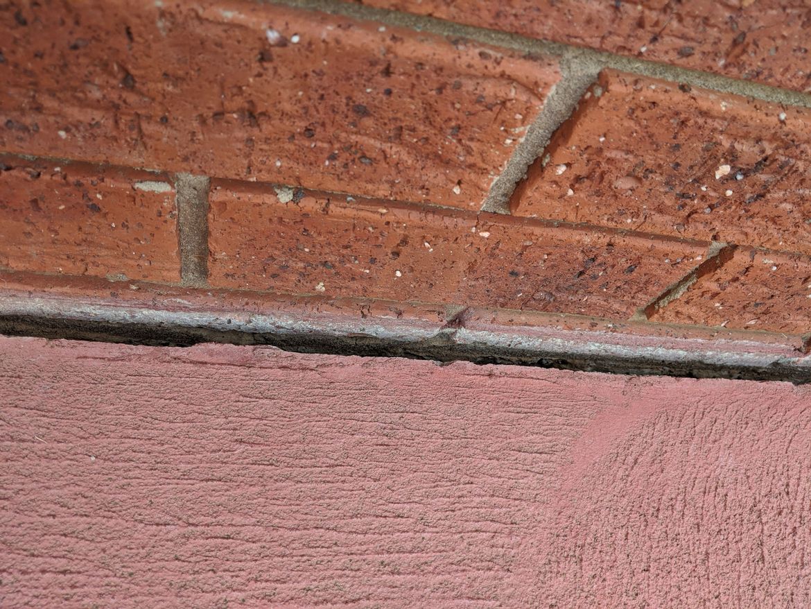

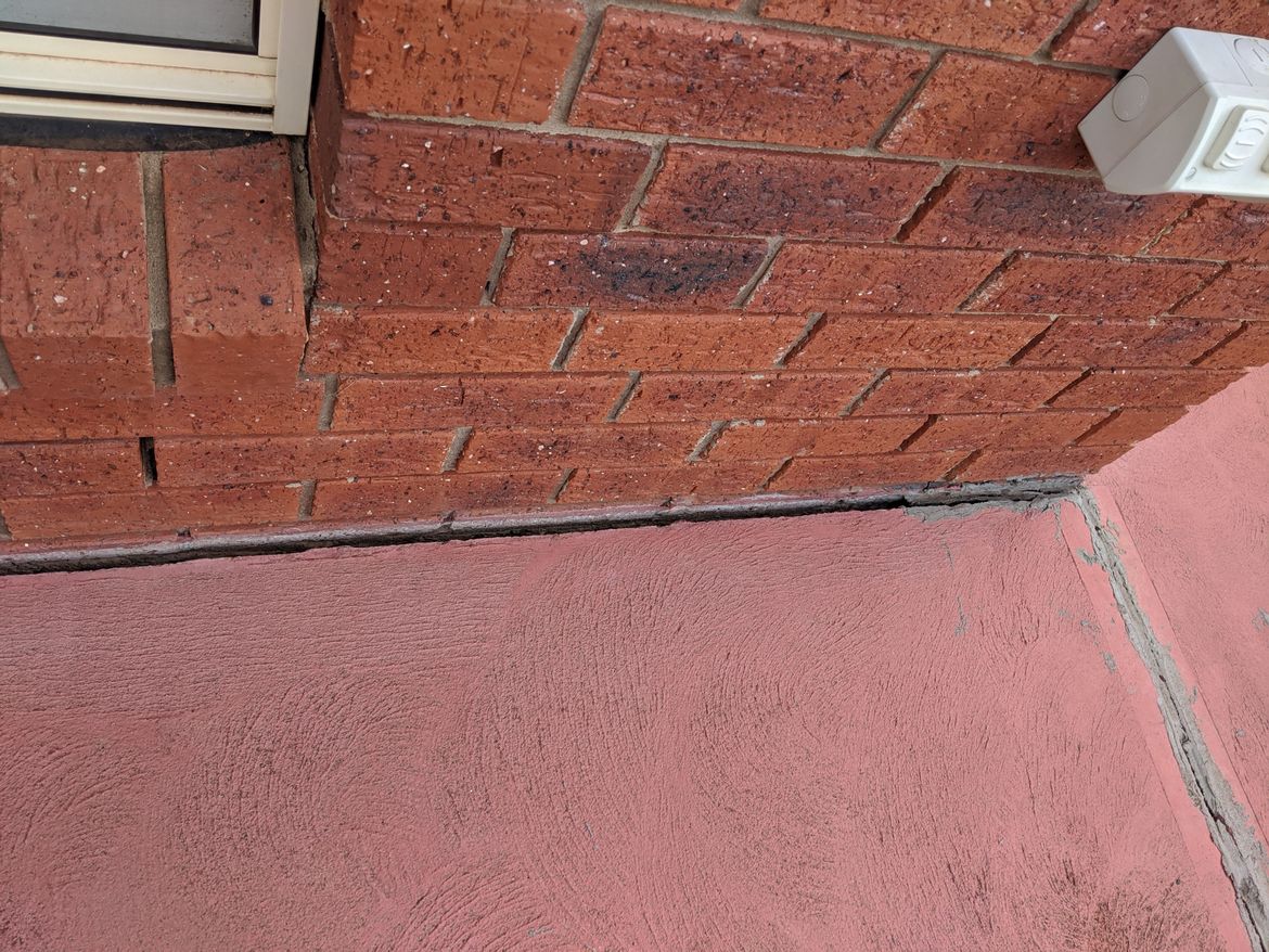

Side path gap due to overtime soil sinking- What is best to fill the gaps ?
iamtheroot
Budding Contributor
I was thinking of few option:
1) to cut the concrete and redo it again - High cost  so don't want to do it
2) Is there a way I can fill the gaps ? and groute it same color ? If so how best to proceed  and what materials needed ?
TIA
IMG_20200308_102521.jpgIMG_20200308_102512.jpgIMG_20200308_102525.jpgIMG_20200308_102533.jpg
Re: Side path gap due to overtime soil sinking- What is best to fill the gaps ?
Welcome to the Bunnings Workshop community @iamtheroot. It's great to have you join us and many thanks for your question.
I don't believe there is any reason to cut the concrete and redo it.
You could mix the correct colour oxide with cement and fill the gap. However, it looks like it is standard concrete which has been painted. It might be easier to fill the gap with a suitable paintable and flexible filler like Sikaflex 11FC. You could then repaint your concrete and give the whole area a spruce up as it appears the paint is coming away in other places.
