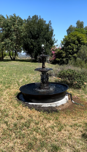

Solar-powered water fountain to add a focal point to the front garden. Underground solar cables and solar panels mounted on post hidden behind trees so as to be inconspicuous and not detract from the view, yet receive full sun. Concrete slab base; poly basin; cast iron fountain; solar-powered pump with battery back up; concrete blocks surrounds with removable section for access to cabling.
Steps
Step 1
Concrete slab: dug circular hole 12cm deep and 20cm larger in diameter than basin. Spread road base on bottom. Levelled and tamped. Used thick plastic garden edging and stakes to make form. Mixed concrete with shovel in wheelbarrow (wish I had a mixer!). Floated and troweled to smooth finish. Basin and fountain installed once slab cured for about a week. Pump installed and connected to fountain. Solar cabling run inside water pipe and buried underground.

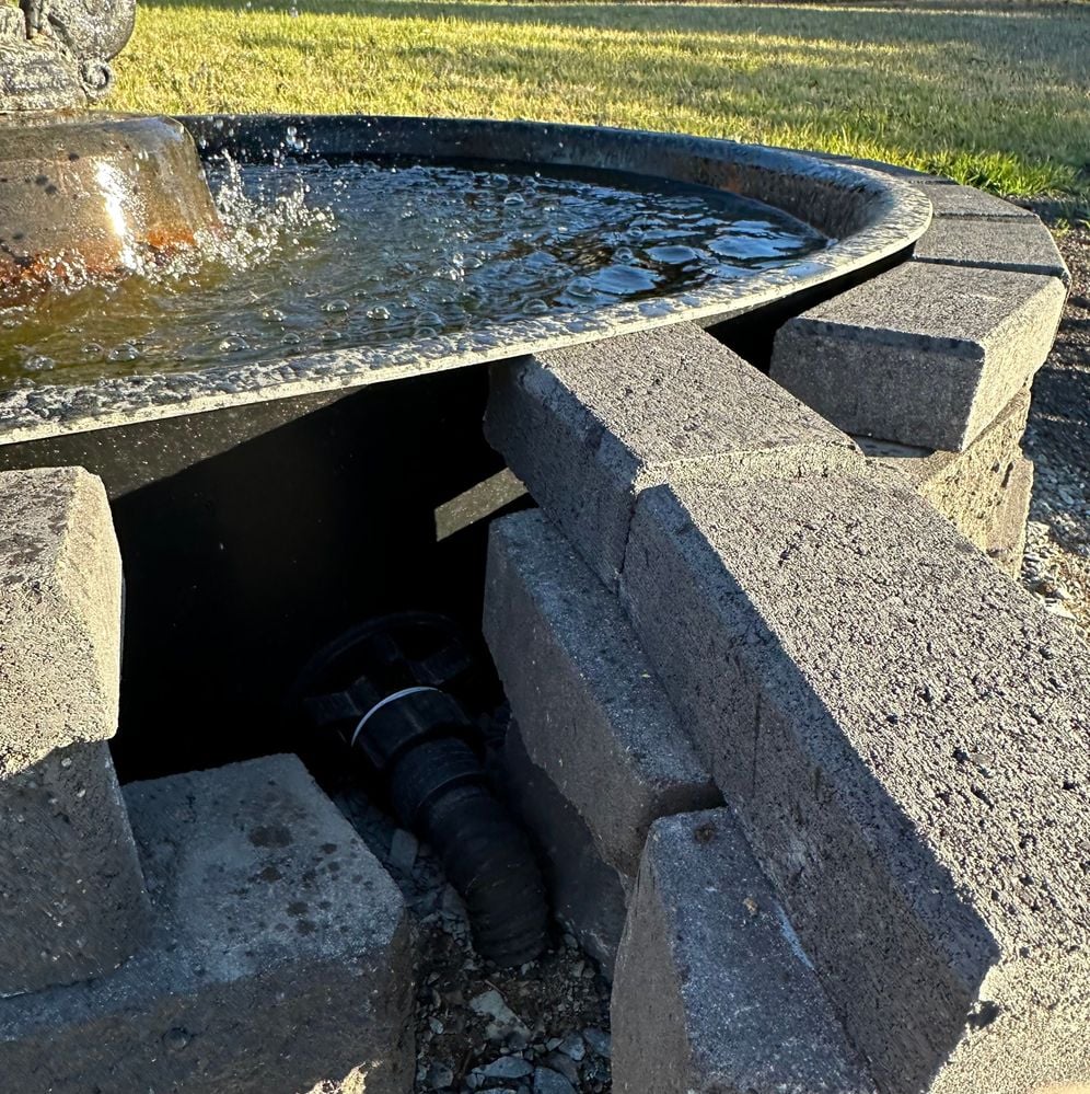

Surrounds: laid and levelled first row of blocks then glued second row on using Selley’s landscape adhesive. Used pavers for top row, glued on using Selley’s landscape adhesive. Used cold chisel and hammer to cut last blocks to size and make a removable section to allow access to cabling.
