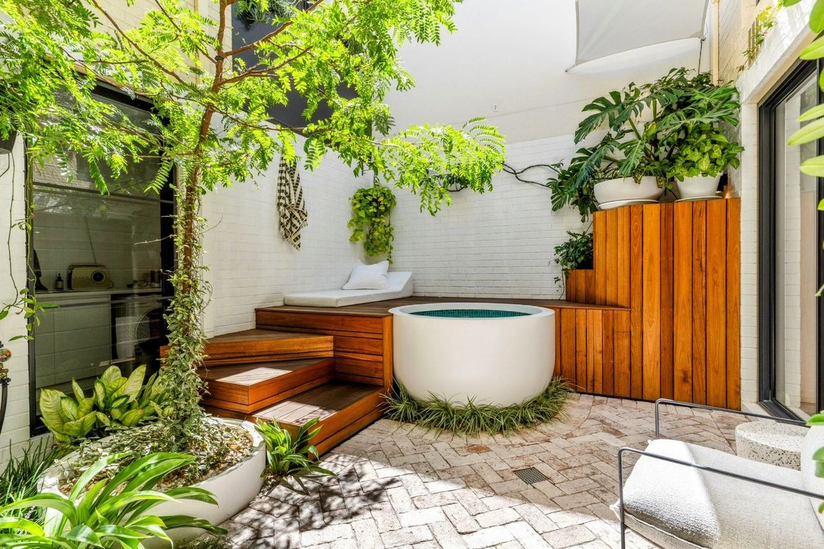

4.5mtx4mt internal courtyard on only a 127sqmt lot.

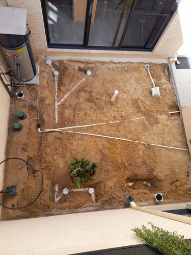

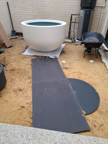

I was hoping to have small plunge pool installed but sewer and other services were below underground. Also all above ground pools on the market were too big, so I had to come up with an alternative. I had a vision of making my own out of a 1.5mt x .900 planter that are usually used in streets scape or commercial areas.

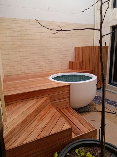

I sealed,waterproofed,tiled and had it plumbed and the end product came out amazing. Also had a very big and ugly hot water system to hide using joinery.
It's a wonderful space that we use all year round.

Exposed services before digging footings for joinery.Exposed services before digging footings for joinery.Getting planter in place on a bed of aggregate.Getting planter in place on a bed of aggregate.Plumbing installed then started on joinery.Plumbing installed then started on joinery.Completed joinery.Completed joinery.

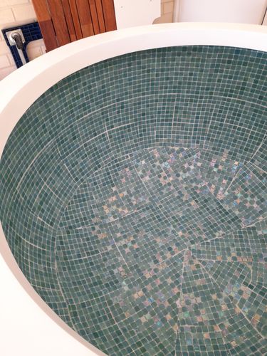

Oh SNAP! you did what? :smile: "I sealed,waterproofed,tiled and had it plumbed" How long did it take you to seal and tile that bowl? and where did your source it! Any chance of a closer shot at the tilework? It looks amazing. Im not super keen on plunge pools but really could imagine sitting there cooling my legs on a hot day for sure.

Pots are made by Pietro, and they are called U Planter. Made from GRC (glass reinforced concrete) so quite lightweight. I was always worried about it holding the 1200lt capacity. Thick waterproofing and tiling added a lot of strength to the shell tho.
The mosaic tiling was quite tricky and fiddly for someone with no experience but end product came up ok.
