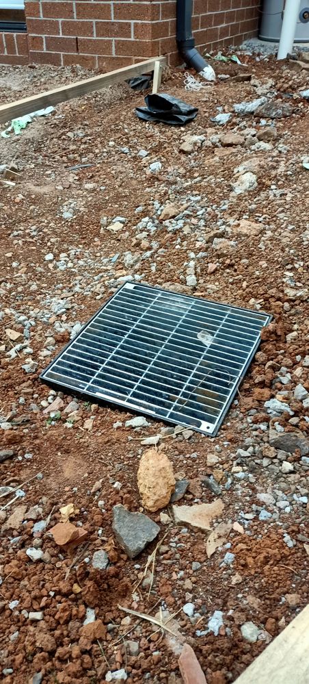

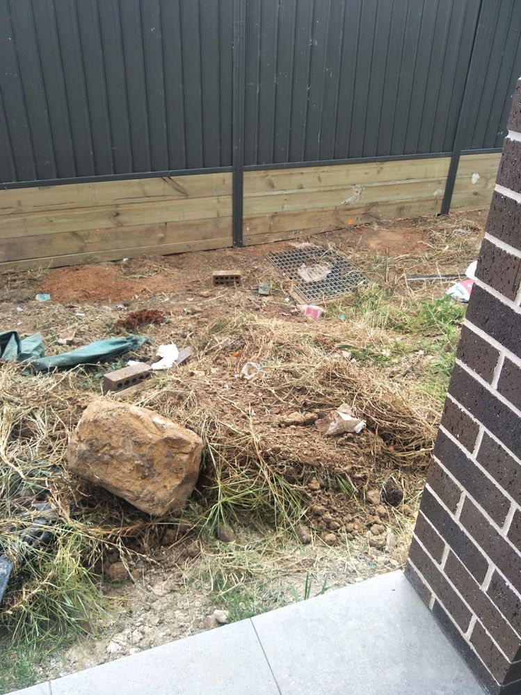

CADD1A88-C13E-45FE-B1A8-96DEA0F91D06.jpegA couple of stormwater pits in the backyard was built too low. I want to raise them. Do I need council approval? Can we do it ourselves and how?

Thank you, I’ve added a picture. The put needs to be raised because the ground will need to be raised as well.
Re: Stormwater pit too low. How to raise
Many thanks for the image @jbob4. It looks like a pit riser that you place over the existing pit to change the height would work a treat. This would be a great solution because the existing pit can stay where it is.
