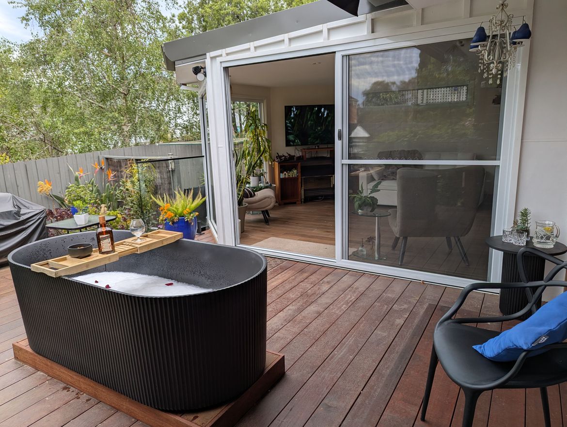

The old patio was out of date and tired, we ripped it down and built an amazing sunroom which gets a lot more use. As for the bath, it's a table by day and a bath under the stars by night or visa versa.

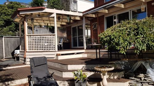

The before shot:

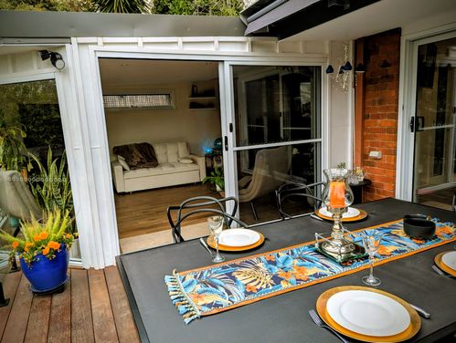

The table is made up with black aluminium pool fence panel and sheet of 10mm marine ply with 7 coats of Dulux weathersheild black

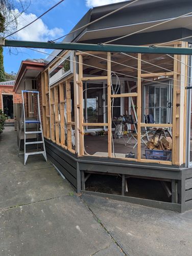

Step 1, partly demolish existing veranda, demolish and remove old decking and lazerlight roof.2. Put in concrete stumps, bearers and joists. 3.Cut and fit new decking boards. 4.Frame old veranda into new sunroom, fit sliding aluminium door and 3 windows. 5.Have a registered electrician as required.
6.Clad external walls and eaves, colour bond roof, 7.have plumber install hot and cold water for the bath.

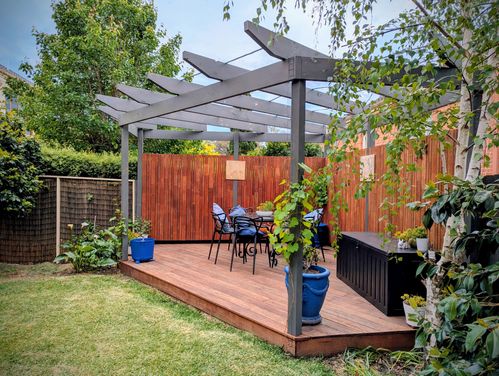

Once this deck sunroom was complete, a new decked area in the back corner of the garden was built catching the late afternoon sun. Just waiting for the ornamental grape vines to grow.
