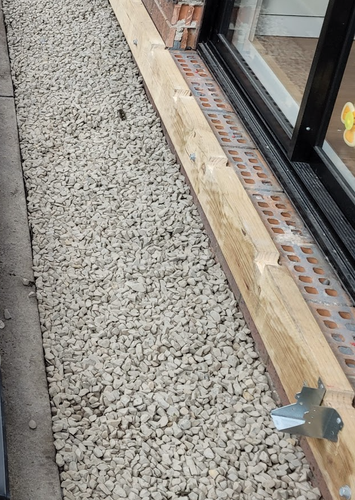

Putting some drainage gravel over the weed mat to prevent it getting shredded by wind over time and double protection from weeds. Also put the protectadeck on top of the bearers (ledger will do after joists are attached). I also put in cross braced strap ties as a precaution to prevent any shaking in the deck, which are tensioned too with strapping tensioners. As a tip, I have ductaped the centres together so they don't cling together in wind. I also screwed them to the underside of 2 joists each to prevent metal clanging. They might be overkill, but it was a quick easy cheap job that should remove any sway that may have been there.
I can't believe what a difference the gravel made even though it's not for aesthetics and will be covered by decking.
Here i have positioned the joists and notched out the bearer to the joists can run flush to the patio door. But don't worry, the little extension on the joist isn't taking any weight, you'll see I use joist hangars later on

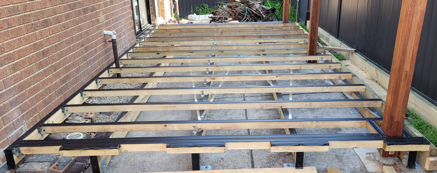

Joists fully installed with some doubling up of supports. I have the joist hangars on the ledger. To attach the joists to the bearers, I have used Buildex 10-8 100mm treated pine screws https://www.bunnings.com.au/buildex-10-8-x-100mm-climacoat-countersunk-ribbed-head-treated-pine-scre... (These are amazing screws! I first tried the slightly cheaper similar size Zenith, and the first 3 screws gave me issues. So I swapped to these). I put in a screw at an angle onto either side of the joist into the bearer (similar to what you would do with construction nails, but I prefer screws). And for good measure, I also attached a multigrip between each joist and bearer at the last and second bearers. I'm pretty sure this wood is well sturdy!
You can also see in the above photos I've lined the joists with protectadeck flashing. Which by the way is super easy to install. I used a normal office staple gun. I put 3 staples in 1 end, roll the flashing along the joist, then at the end I pull it tight so that there are not creases and it runs perfectly straight. I then staple that end down while I have the pressure applied. Then after I just go staple every 30cm or so and that's it. You can see how well it came out.
You'll also see above the additional support I put in for the end framing decking boards that run perpendicular to the main decking boards. And on the right you can also see I've temporarily put in place the first layer of my raised garden bed just for sizing and spacing.
