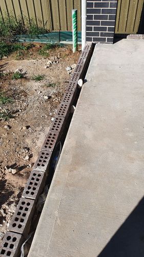

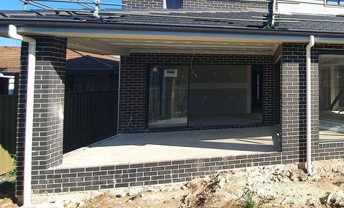

We are in the final stages of construction and didn't include any tiling/decking on the rear outdoor area and I think I'm regretting not having it included now that I've seen the finish with the bricks on the outside.
I was going to do this myself after handover so I'm interested in how it should come together since it's raised with the exposed top of the external bricks without capping as well as the gap between the slab.
The step down at the doors is 76mm so I'm concerned it's not high enough for joists below the timber slats?
If I was to tile the area, what's the best way to fill that gap and go to the end of the brick? The screed would also need to be a good thickness.
Also, I think a railing/balustrade is going be a challenge to fix to the floor over those bricks since I couldn't fasten posts outside of the slab area? I'm guessing it will need to be at least 1 brick length inside to fix to the slab itself?
