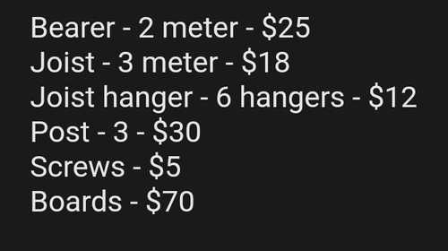

@MitchellMc Hey mate, are you able to help me with cost estimation of this plan against any unit of measure such as per sqm? I've done mine per sqm but just not sure if this is correct or not
Hi @RS,
I've had a look myself at those figures and my cost estimation is very similar to yours. Please bear in mind this is just a rough estimation and doesn't necessarily translate well into the real world. You'll need to take into account stock availability of the timber you need and over length wastage on each piece of timber. It does, however, give you something to work with.
