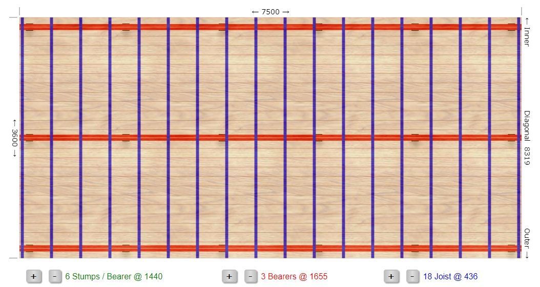

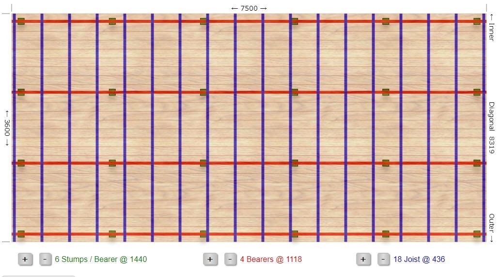

I'm completely new in terms of building a deck and a friend of mine with more idea than me will help me build it. So the plan is to completely deck the backyard area and build up some planter boxer.
The dimensions will be: 3600 x 7500. The ground is uneven so the height will vary in between 250 mm (closer to the house) up to 400 mm
I have many many doubts and I've been reading so many posts here, even went to the calculator https://www.blocklayer.com/deckcalculator.aspx to see if the info i've been getting would be right or not.
My first question is:
BEARERS:
How far should I put the posts? Following another thread which is quite similar to my idea, he placed the bearers @1800mm from each other. Knowing that the width is 3600 mm should i place them at the distance that the calculator gave me: 3 bearers @ 1678mm or 4 bearers at 1118mm.
Should I go with 2/140x45 F5 TP or Just 140x45 F5 TP or even 90x45 or 2/90x45? It would be a continuous span but i'm having trouble to read the tables you guys were posting.
Should I use gal stirrups or timber stumps?
JOISTS: For what i've seen: 140x45 H3 treatment pine @ 436 mm. Is it ok that separation in between joists or should I get them closer/more separated? I've also thought about using joist hangers and install joist between the bearers rather than on top, due to lack of clearance (only around 500 mm from floor level to ground), so I also appreciate your thoughts on this.
I attached two options of what the calculator gave me.
Every single reply will be highly appreciated!
Thank you!!
