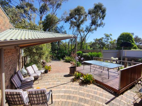

I have got an outdoor deck, 3x4 m - see photo. Left size is sun facing west.
Would like to cover it during summer and I thought a sail shade may be the cheapest option.
Can someone please suggest what type , size , orientation , how the sail shade should be installed? Also where to install post?
I will see if i can do the job myself if its not hard , otherwise I will look for a tradie.
Any other suggestions welcome.
Many thanks

You'll likely be looking for a square 5m x 5m shade sail. Depending on when you are most likely to use the area will affect the orientation. If it's at midday, then the sail would be positioned directly above, but if it's in the morning or afternoon, perhaps you'd like to angle the sail towards the East or West.
Don't rule out a large cantilever umbrella, though. They can provide close to the same amount of shade as a sail and more if they are re-positioned to block out the sun throughout the day. For example, this Coolaroo 3 x 4m Charcoal Brampton Cantilever Umbrella has a span of 3 x 4 metres. This Coolaroo 5.4 x 5.4m Graphite Square Commercial Grade Shade Sail is 5.4 x 5.4 metres from the shackles. It does not provide 5.4 x 5.4 metres of shade. It's actually more like 4 x 4 metres in a fixed location. So, in my opinion, the umbrella would be a better choice purely because you can angle it to block the sun more adequately.

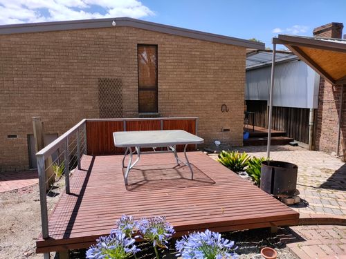

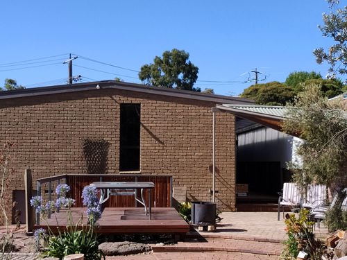

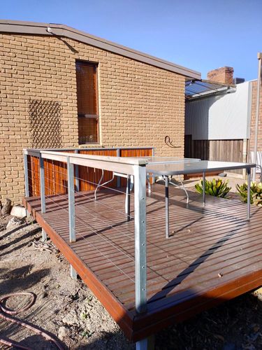

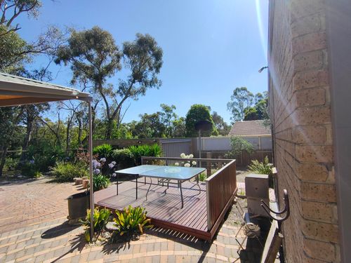

Also, I am having a look at Gazebo – What’s your view on that? Is it suitable for my deck? Which one will you recommend. Please see attached more photos of the outdoor  layout.

We have a whole range of umbrellas you could use on your deck @Thierry. I selected the Brampton as it is a cantilever and has the largest size canopy at 3m x 4m. It does tilt up and down for angle adjustment. A cantilever umbrellas stand is off to one side, freeing up space in the middle of the deck. See the image below. They include the base in the kit.
A Gazebo would be another suitable option. The choice of which one you go for likely has mostly to do with budget and taste. You'll need something that either goes on the 3 x 4m deck or that is larger and gets fixed to the ground. Anything larger than the deck will be impeded by the current awnings post. You'll need to look at the semi-permanent options as the non-permanent ones can't be left up all the time.
