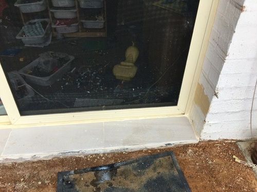

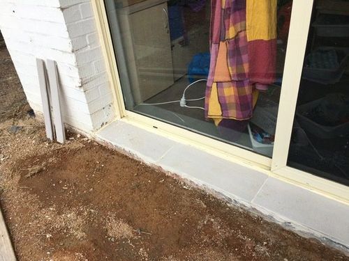

So I finally got my tiles and was able to finish the job. I am very happy with the results. The whole lot is water proof and will stop any further water damage inside the room. ACEDCEF8-051C-476C-BC0E-1960AA07F965.jpeg

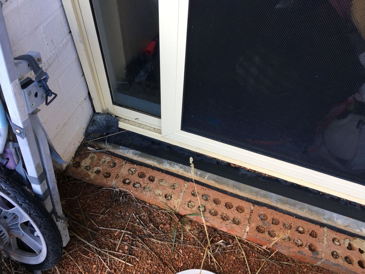

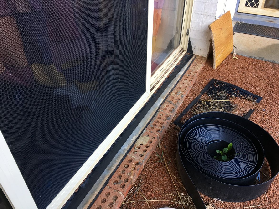

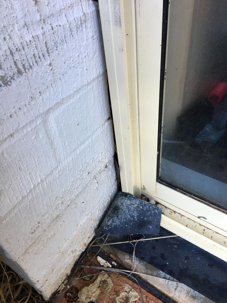

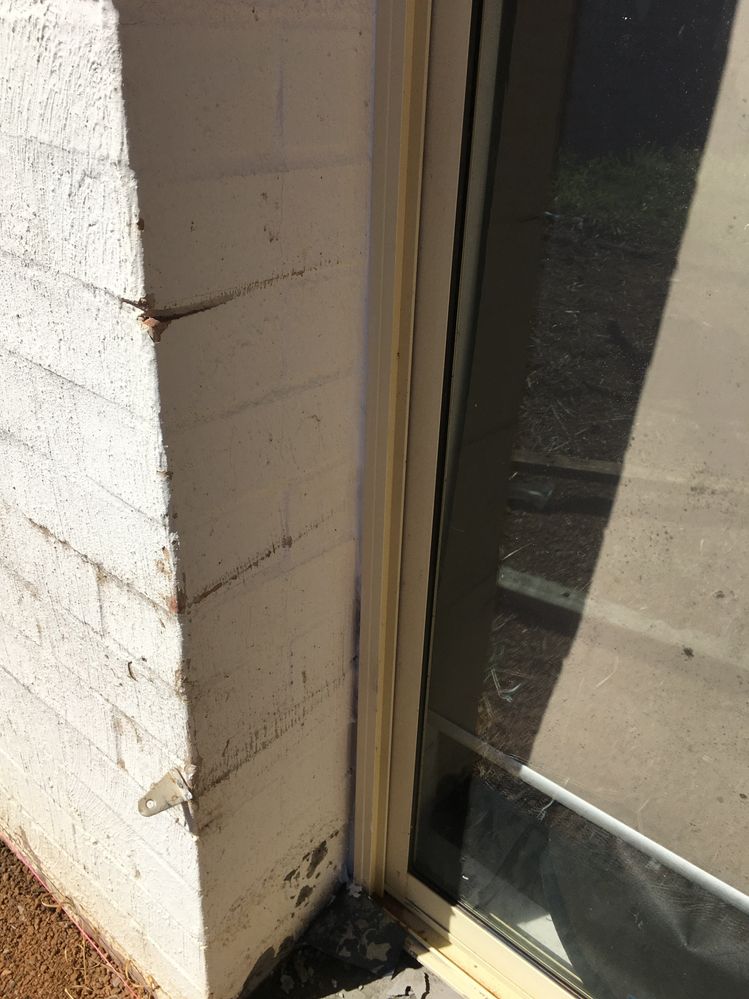

So this is my first post.  My husband moved out a month ago leaving me with three kids and a heap of half finished DIY projects around the house, some older than my 15yo.  This is probably the most urgent one.  When our third child was on his way we decided to convert the attached garage to more living space rather than moving.  We had a builder do the work but he didn't complete the door sill around the sliding glass door that replaced the roller garage door at the back of the garage.  Because it is unfinished there is considerable water damage to the trim, walls and carpet inside the room.  Before I deal with the water damage I am going to make the door waterproof.  I was thinking I would need to clean up the brickwork, put up some form work, screed off the area with a suitable concrete type product and then once it is cured I will tile the sill to finish it.  I also need to do something about the gap around the rest of the door, I was thinking of sealing it with a gap filler, painting some beading to match and gluing the beading on.  I am a total novice at this sort of work but fairly handy and more than willing to learn.  IMG_1804.JPGIMG_1805.JPGIMG_1808.JPG

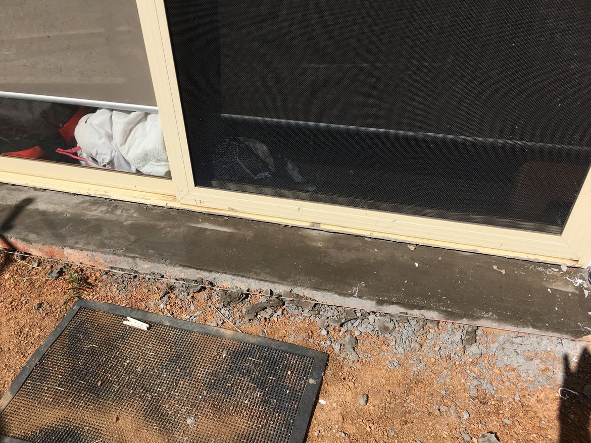

Ok I am editing to add some progress photos.  It took me a few weeks to get the shed and yard cleaned up enough for me to find what tools and materials I had available. And last weekend I finally got the screed laid on the door sill. I am hoping I will be able to get the tiling done next weekend.  IMG_1925.jpgIMG_1926.jpgIMG_1929.jpgNot bad for a begininer I thought. The gap is too wide towards the bottom, I will have to go over it a few times to actually fill it up.

Yes I would love some advice. I want to know if I am on the right track with what I plan to do to fix this, any recommendations for products to use, and any tips, tricks, and techniques to help me with it.

I do have one very important question, do I need to put a slope on the new sill to provide drainage? If so how much?

Sounds like you have got it pretty much covered with your explanation Mel.
Setting up some formwork is a great idea and it makes it much easier to keep a straight edge for your render/concrete.
Just remember to keep an eye on your thickness so you don't have issues with a lip against your slider. Personally I have always left a little bit of a slope or fall away from the slider so it doesn't run back into the sliding channel.
As for the gap a silicone will do it but you may also be able to go to Bunnings or your local Glass and glazier and see if the have any matching powder flat Bar to either silicone on or if you are able drill and pop rivit.
I hope this has helped a little bit, I've really only emphasized the same procedure you had in mind.

Thanks Rob that is great. And thanks for the tip about a matching metal edge that would be better than some timber beading. Should I worry about sloping the edge to allow for drainage or is it too small a space to worry about it? Thanks again.

I wouldn't have a huge slope and yet I would put some fall outwards.
Say about even 4-5mm in 100mm wide.

Thanks Rob. That is what I thought. I will give it a go. I will post pics as I have progress. First I need to clear out the shed and see what tools and supplies I have available. :smile:
