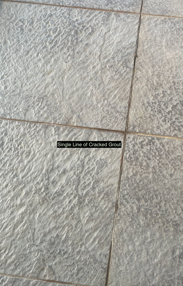

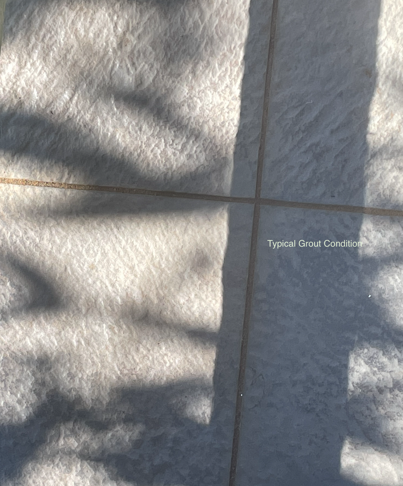

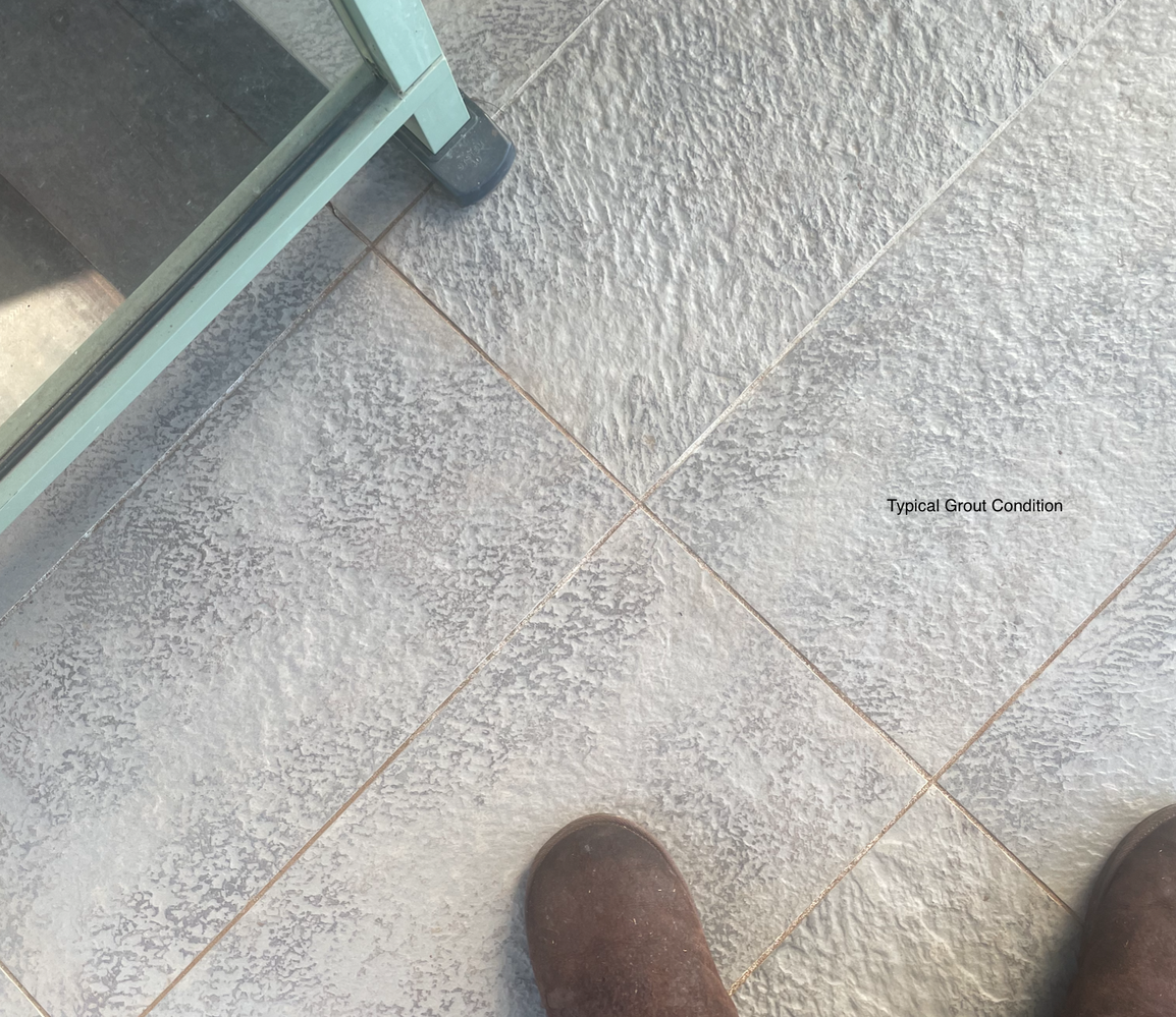

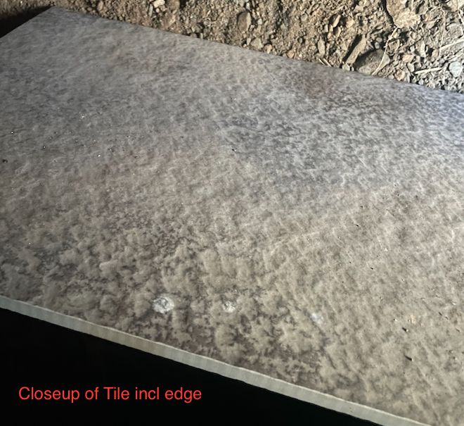

Most of the grout appears in reasonable shape. There is 1 line of grout which is cracking and showing signs of degredation. Photos attached.
