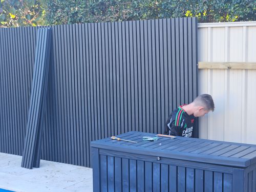

I have been installing the castellated panel from Ekodeck, cutting the 3.6m lengths into 2. Is there a trim that I can use to finish the top edge?

could you please go into some more detail about capping the top using an off cut piece of the ecodeck panel please? Just having a tough time imagining how to do it. As if the panels are vertical, then the capping would have to be horizontal along the top.
Welcome to the Bunnings Workshop community @jye1. It's marvellous to have you join us, and many thanks for your question about capping.
Yes, you're absolutely right — since the Ekodeck castellated panels are installed vertically, any capping piece would be fitted horizontally across the top to finish the edge.
If your panels finish flush with an existing fence or structure, you may be able to use that as a fixing point for the horizontal top capping. If not, and the panel is freestanding, then you’ll likely need to install a length of timber (such as a treated pine batten or similar) along the back top edge of the panel to act as a support for the capping piece. This will give you a solid base to screw or fix into.
The capping itself can be made from a ripped-down section of Ekodeck board, which will give you a consistent look and colour match. Once cut to the right width and length, it simply sits flat across the top of the vertical panels, like a lid. You can lightly sand the edges for a clean finish and attach the piece using Ekodeck screws or hidden fixings for a neater result.
