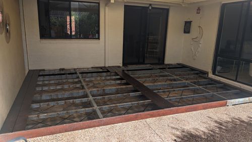

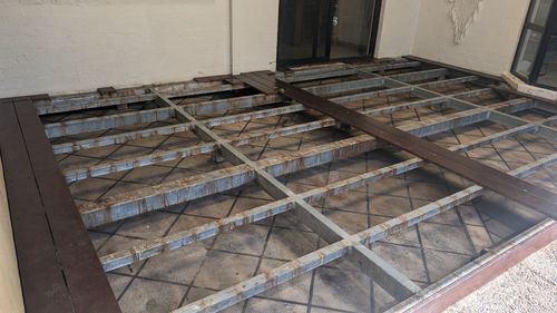

hello friends, we had to take out the wooden decking in our alfresco area as water was getting retained underneath. Now while taking the wooden decking out there is a metal structure underneath
which we are not able to take it out. I am looking for the flooring options that I can do it myself. Please note we have a dog at home and not looking to putting wooden deck back on.

I'm sorry to hear that water is gathering under your deck. Is there no way to provide a drain for it? I only ask because you have a steel frame for your deck. This is special and often means that the person who had it installed wanted it to last a very long time.
Were the boards used for your deck timber or composite material. If it was composite, then your deck would definitely have been very expensive. I encourage you to find a solution for the water to get out under that area as it is worth saving your deck.
The steel frame was probably installed using concrete anchor screws or it was welded into place. Either way these attachments will need to be unscrewed or grinded off in order for the frame to be removed.
