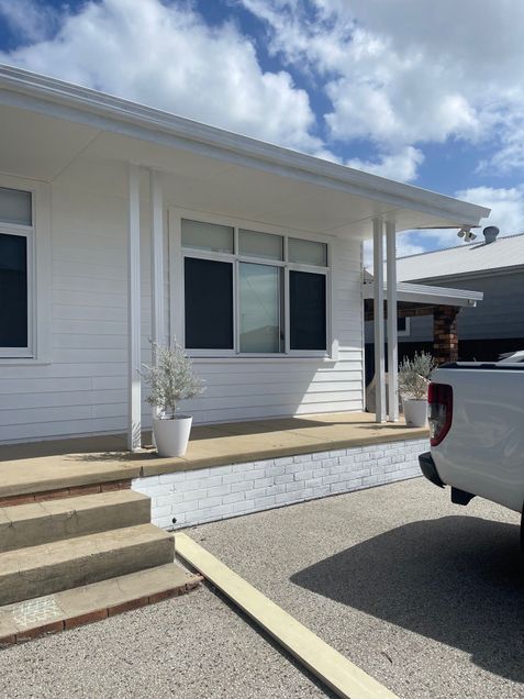

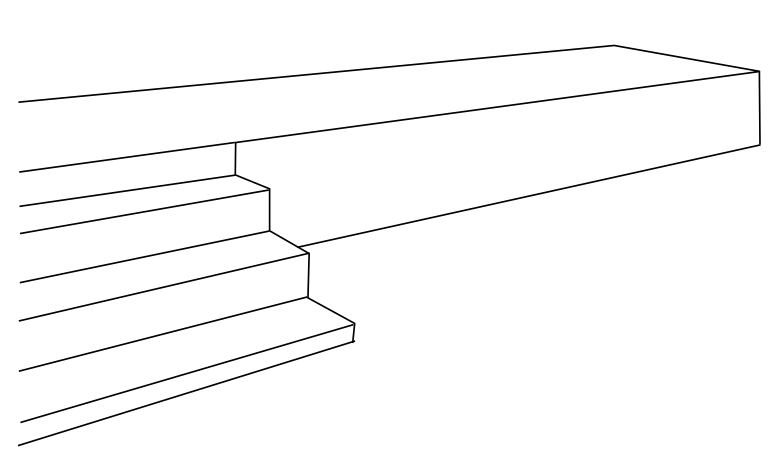

Hi All,
I’m looking to add a balustrade to my deck and would appreciate some advice.
  • Deck size: 4480mm (wide) x 1690mm (deep), with stairs approx. 1070mm
  • Slat height: approx. 800mm high
    (Note: the drop-off is less than 600mm, so a balustrade isn’t required by code, but I’d like to install one as a safety precaution to prevent accidental falls.)
  • Style: Vertical timber slats
I’m looking for recommendations on the following:
  • Suitable post size
  • Appropriate post brackets (to be bolted into a concrete deck)
  • Horizontal rail timber size [Notching into posts]
  • Recommended maximum span between posts for stability
  • Ideal vertical slat size (I was thinking around [92x18 mm]
If you need any more information to make suggestions, please let me know.
Thanks in advance for your help!Deck Setout.pngDeck.pngSlats.pngFront D,eck.jpg

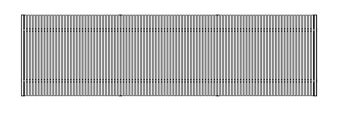

Hi @MitchellMc
looking to achieve something like the below [hope this makes a bit more sense] i drew that drawing to scale thats why it looks a little bit weird
Re: What balustrade timber?
Now I see @jaydenRadisich. I think 90 x 42mm would be a good idea for rails if you are looking to place posts at 1800mm. If you went down to 1500mm, you could get away with 66 x 40mm rails, but you'll probably need a chock under the bottom rail at the midway point for support.

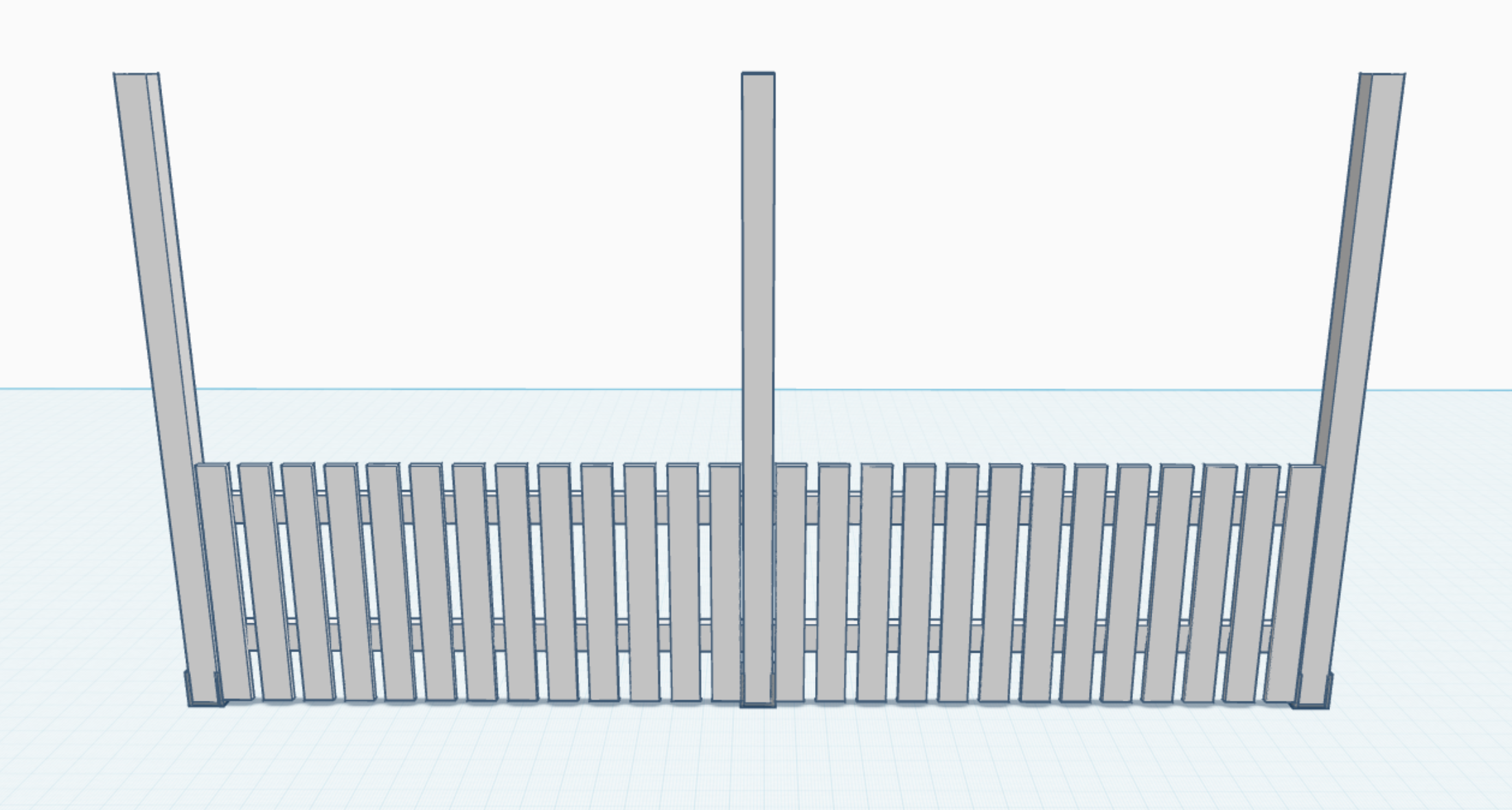

I've created a rendering using those materials and the 36mm gap @jaydenRadisich. That will give you a better idea of what it will look like.
I'd recommend Zenith 10 - 8 x 50mm Galvanised Countersunk Rib Head Timber Screws. Brads will typically rust in external environments, unless you use stainless steel brads. Even then, screws are the more secure fixing method.
