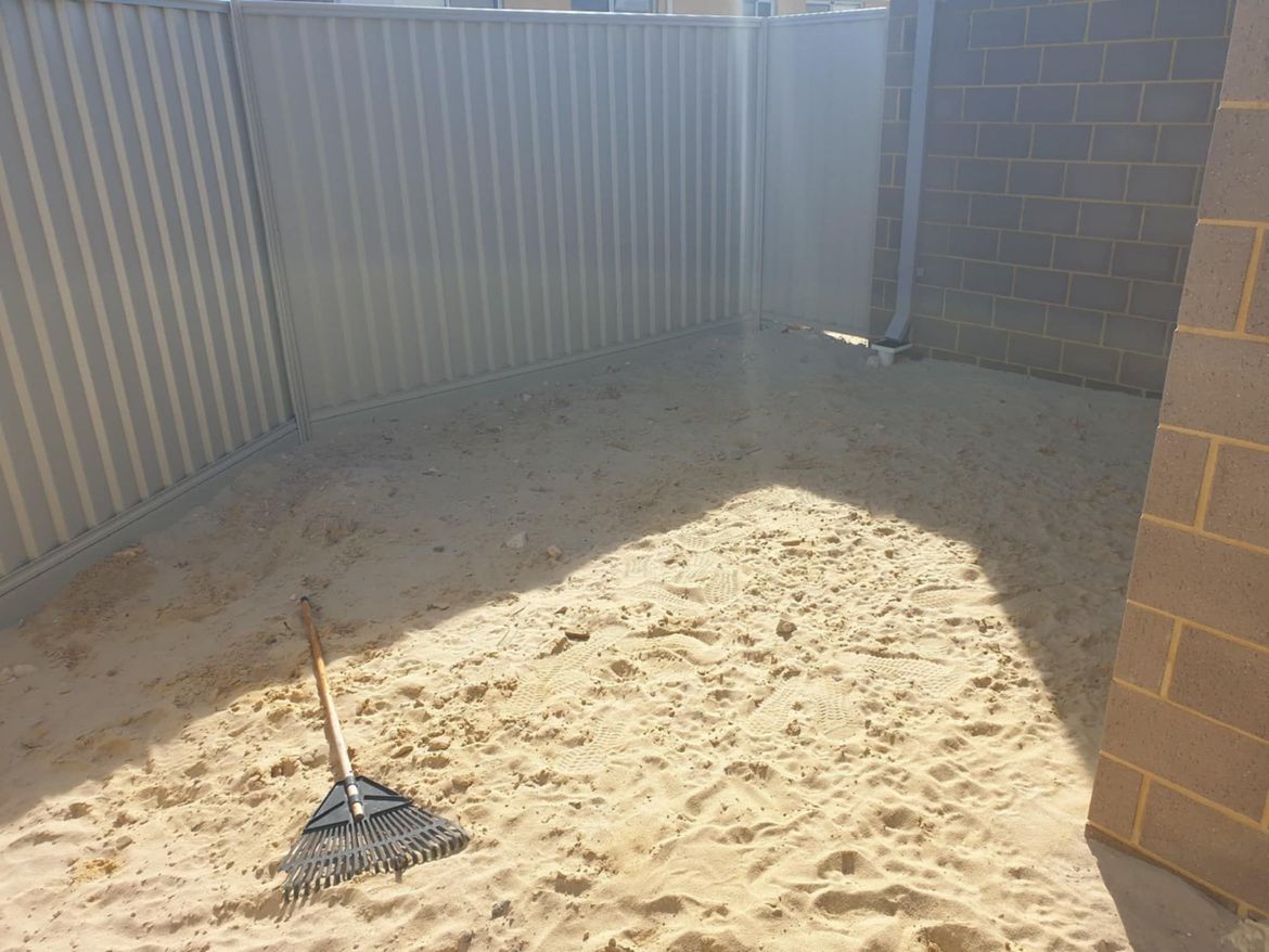

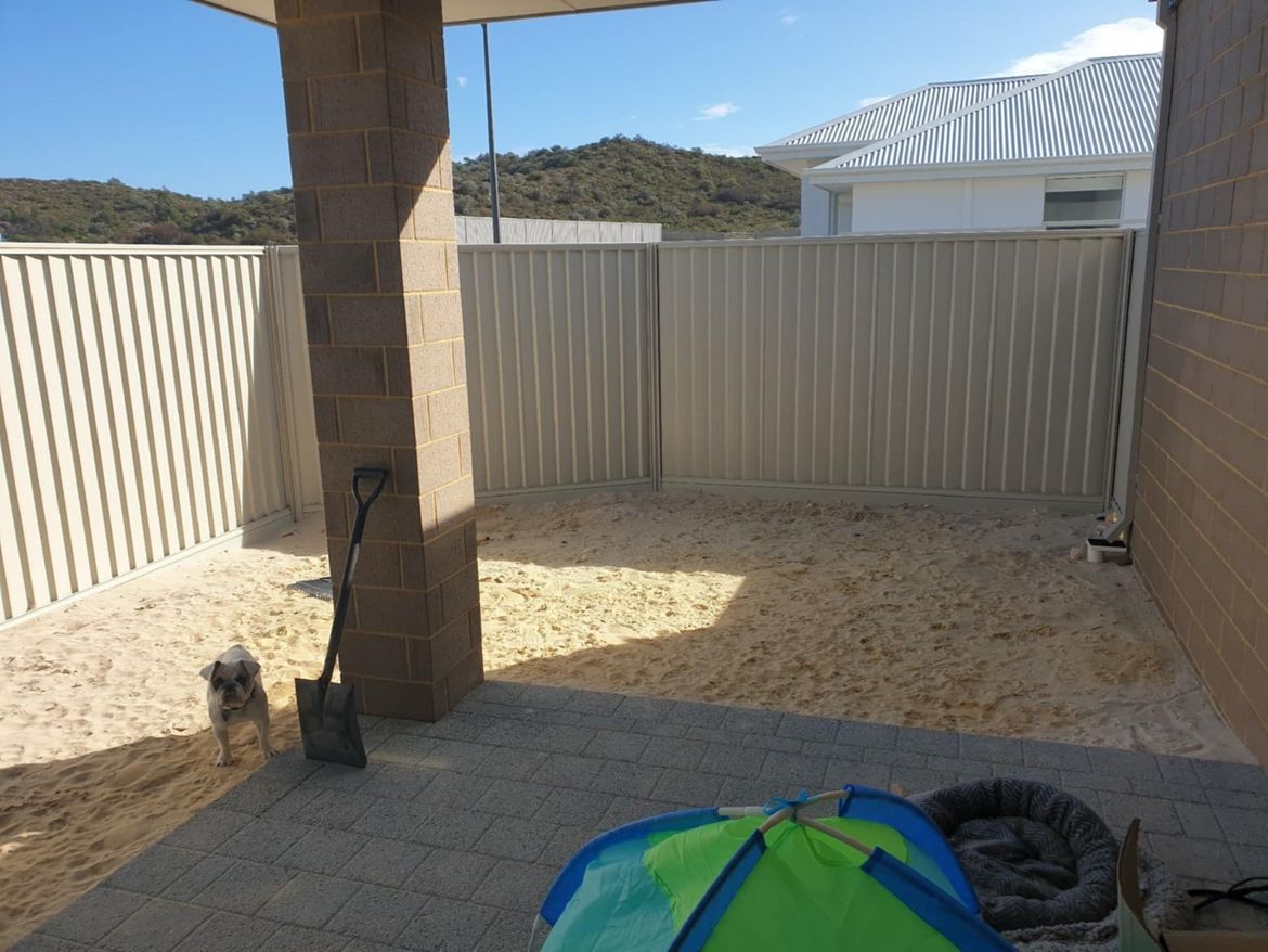

Hi, I am wanting to install 600x600x10mm Outdoor Porcelain tiles to my Alfresco area which is currently just sand and need to know the best base to use? The area is around 20m/2, I will be removing the current pavers and replacing with the tiles.

I'm afraid the only viable base I can suggest is concrete. It has to be firm solid and unmoving because of the nature of tiles. If you do decide to lay down a concrete base, it's critical that the slab has a proper fall so that water does not pool on its surface. This would also be a good opportunity to install proper drain channels on both sides of the slab.
You're in luck as I can see a storm water drain near your wall. This will make it much easier for you to point your slab drain towards your storm drain. Once the concrete slab cures properly, you can then begin planning your tiling project.
Let me call on our experienced members @diy_hausdesigns, @homeinmelbourne, @Dave-1 and @Nailbag for their recommendations.

Agree with @EricL on all his points @verjones2016

@EricL has nailed it. I agree with his and @Nailbag 's suggestions. All I can add is to think where you want low point to drain to, Eric has suggested the stormwater point but you could extend that out to elsewhere with a pipe. Also Factor in an outside power outlet or even lay down conduits for potential future use.
