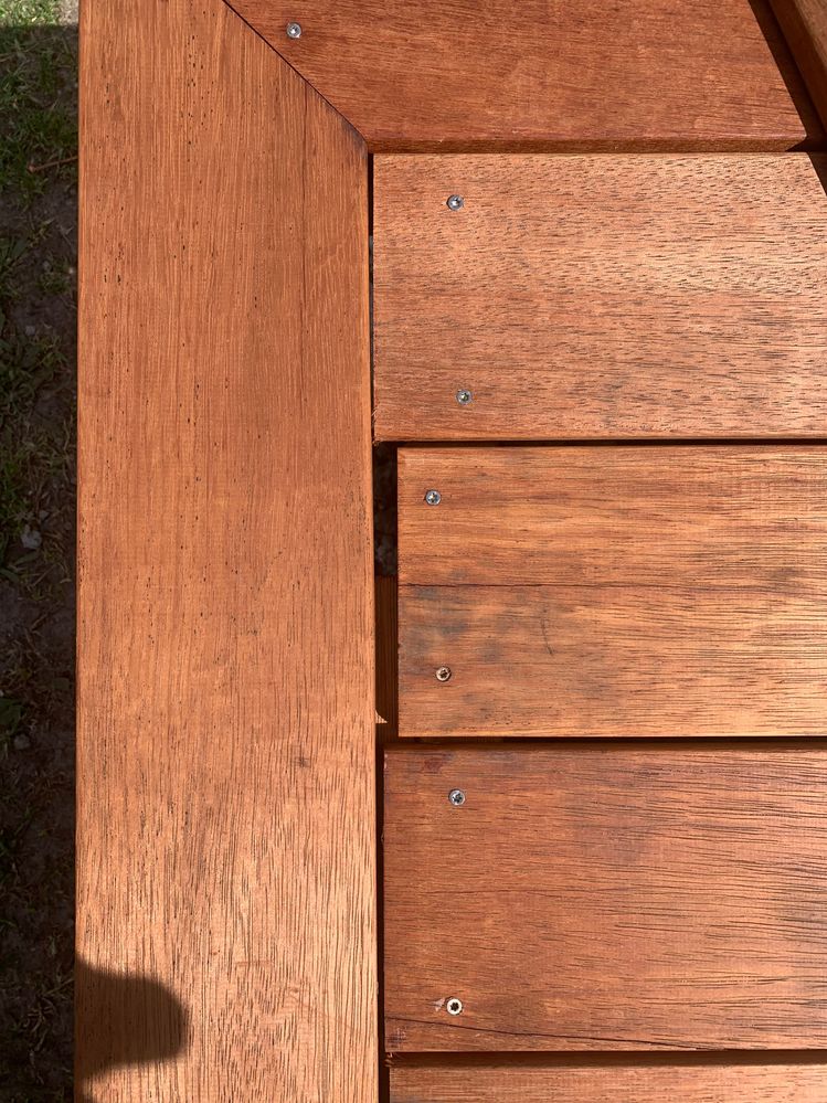

I've finished my backyard deck but there's uneven ends towards the border... i was wondering if there's a way of either covering or filling in the gaps without it looking as ugly as it does in this photo... thanks.
All that I could think of is cutting pieces off of the off cuts and gluing them on the ends to fill the gaps... or using sawtooth stairnose trim along it... the decking is 13m long... IMG_0369.JPGIMG_0368.JPG

I think the best course of action would be to remove that edging board, set a circular saw to 19mm depth and trim all the boards in one cut to the same length. The trim board can then be re-installed. If the board is then not wide enough to cover the frame of the deck you could use a larger width board like the 140 x 19mm KD Select Grade Merbau Decking to frame the deck.
Personally, I can't see inserting small offcuts as being particularly aesthetically pleasing and it would take away from the amazing job you've already done.
You should find this tutorial helpful: How to lay decking. It shows how to mark a straight line and cut all the boards to the same length.
