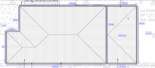

1) hope this hooks wont spoil the facade look or i will paint it with Eaves white
2) total roof perimeter area i calculated for my home comes around 73390mm which means i need 73 hooks if i go one hook per meter - Is this seems to be too much hook (attached image below)
First floor roof area = 52920 mm = 52 hooks
Alfresco roof area = 20470 mm = 20 hooks
3) some of the roof area i cannot reach bec my Garage wall is on zero lot near to fence and also the Firstfloor roof above Alfresco roof.
4) bec its 2 storey with 2.7meter ceiling heights of both floors, only challenge for me is to reach this hook which is 5.7 meter height from ground level to hang the serial lights around the perimeter of my First floor ceiling
Hi @Samara1,
The number of hooks you install is entirely up to you, but there is no real need for one every metre as they do not support much weight. You might consider spacing them out slightly, maybe at 2-metre intervals. This would give a draped look to the Christmas lights that I feel would look very nice.
I don't have an advisable method for you to install them yourself at that height and with limited access, so it may be worth asking your builder to install the hooks at the same time they are installing the eaves. They could then be painted over when the eaves get painted blending them in nicely with their surrounds.
When it comes to the time of year, when you need to install, or remove the Christmas lights, you could use a Hy-Clor 1.2m - 3.6m Extension Pole 3 piece with some Selleys 75g Ezy Tack to get them into place and remove them.
Let me know what you think and if there's anything else I can help with.

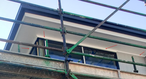

Do you the timber piece running under the eaves as points in red arrows below?
could i just screw the hooks in this timber piece and install the serial lights which is closer to wall and also the 450mm eaves protects it from rain
Hi @Samara1,
It appears that you could fix into that timber.
You might want to check with the builder about using their scaffolding to access the site. I can't imagine their insurance would cover your usage. A construction site is a dangerous place, and access is typically restricted to construction workers until the final handover is completed.
