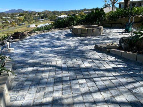

I will be laying some cobblestone pavers on a bed of crusher dust/cement mix and then sand/cement around a firepit so only foot traffic.
The gaps between the cobblestones are 10mm. What is the best way to fill the gaps. Most sands are <5mm so was thinking some sort of grout.

You can use a wide joint grouting compound such as this Dunlop Mid Grey Wide Joint Grout. This product can be used for joints between 5-50mm wide.
Adding some Dunlop Primer And Additive will also help to increase the flexibility and water resistance of your grout, keeping it cleaner and better for longer. While not 100% necessary, it is certainly worth considering.

Fantastic thank you Jacob. I’ll definitely add the primer and additive. Really appreciate the advice
